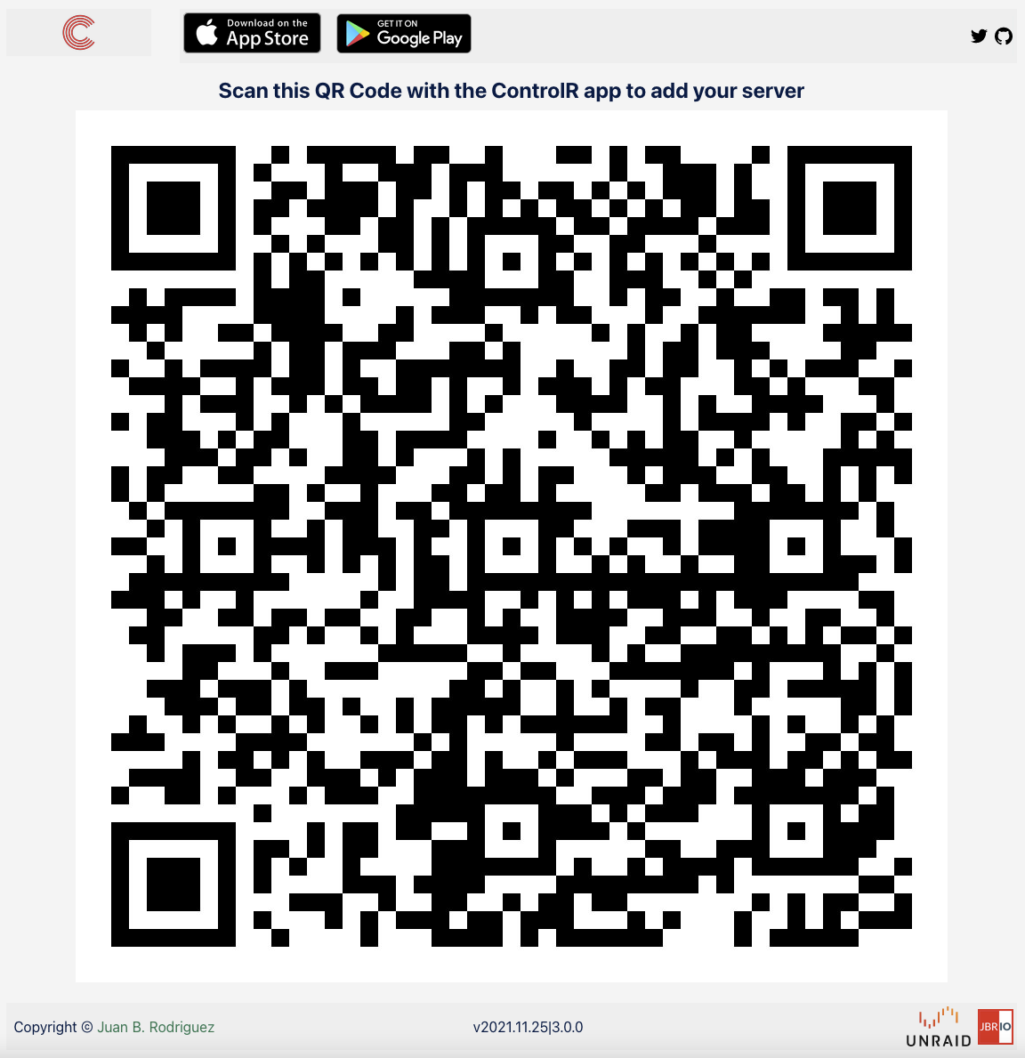

When I click on the link on the plugin settings to bring up the QR Code it fails "cannot access this site".
I look at the URL and it is using https with port 2379, if I change the url to http and port 2378 then the page comes up.
If I remove the Management Access settings (unprovision the server from *.unraid.net) then the plugin works just fine. So maybe there is a something going on that is preventing this plugin from working on *.unraid.net.

I think what's happening is that the plugin can't detect that you're provisioning/unprovisioning the server.
At plugin startup, it checks if it's running on an http or https server.
It seems in your case, it started with http, and after provisioning the server, it switched to https, but the plugin doesn't know about that.
Can you restart the plugin after you're provisioned into x.unraid.net, see if it works ?
i got it to work.. the link is opening to port 2379, when in fact it should be 2378, but in addition, the link is using SSL and i get a SSL protocol failure:
towerone.local sent an invalid response.
ERR_SSL_PROTOCOL_ERROR
it works if I change it back to: http://192.168.1.105:2378
so i got the QR code to show up but in the app there is no where to scan it, android app btw
edit:  i ended up manually adding the server and then it worked.. it also turned out that since i use pihole, i needed to add towerone.local in my dns settings for that to resolve correctly, after i did that it worked fine.  thanks for the help!

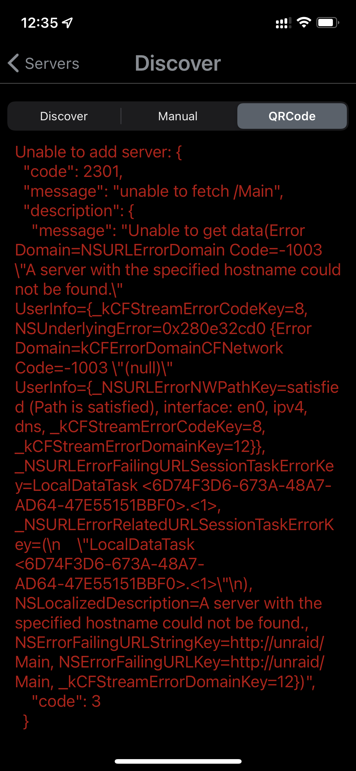

if i scan the QR code on my iphone i get "unable to add server : {"code".:2301, ......
unable to fetch /Main etc etc.
if i add manually without the qr code, all works
Hi, thanks for the report.
So the issue seems to be that the controlr plugin that creates the qrcode is not working correctly. It says that the hostname should be "unraid" but it's not being recognized in the network.
What unraid os version you have ?
Version: 6.10.0-rc2

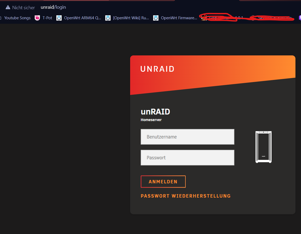

On 2/24/2022 at 2:05 PM, jbrodriguez said:
you mentioned you access via \\unraid, that's the shares right ?
can you access that same way via the browser ?
image.thumb.png.7ea27f81e7c7d7cba1da52c584809866.pngyes
if i use just "unraid"  (http://unraid ) in browser, it redicts to unraid just fine
ports in LAN are not closed / rejected - all enabled for lan only access
edit2:
fixed by set a host entrie in openwrt
unraid ----- lan ip
now on iphone QR scan works
maybe a iphone thing bcs on other device it works without openwrt host entrie^^
