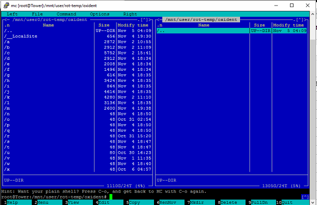

Some shares on /mnt/user/ are empty. When I ssh in and look at /mnt/user0/ I can find my files. What could have caused this?
/mnt/user/ = All shares & files
/mnt/user0/ = All shares & files EXCEPT those on the cache.

That I knew about /user and /user0. That is not the problem.
With no files added, and no changes, the SHARE shows no files.
The looking at /user and /user0 were to verify that my files were still there. Shouldn't the share show files regardless of which /user directory it is in?
Again - the look at the 2 /user directories was to look for the files. It is the share that is not showing ANY files.
