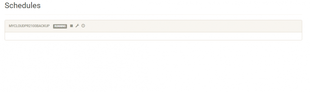

Hello, I have set everything up yet nothing seems to be happening. It says running next to the folder but no files are being downloaded.
There are no warnings or errors in the logs and I am sure all paths and relevant usernames/passwords are correct.  What can I do to troubleshoot this?

The most likely reason for a schedule run not picking up any files is that any defined filters are not matching files it finds in the given folder. You can test this by creating another schedule identical to your current one, but with no filters defined. If it starts downloading every file in that folder, you know it's a filter issue.
Another thing to do is first set the application log level to DEBUG (in App Settings), create an identical copy of your schedule (including filters) and then run it. Attach the davos.log file so I can see.
A future feature of davos will be to wipe the "files in last run" so creating new schedules isn't required.

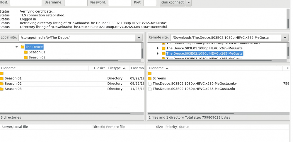

I hope this isn't a silly question but is the folder that davos found empty? The logs are telling me that it got as far as observing it found a directory, so created a local version ready to iterate over its contents, but there weren't any files to iterate over, so it finished processing. Also based on the scan, it only perceived that one folder to be new (everything it saw previously was ignored, as it expected).
@Stark defintely had files in the folders.. tried a few times also removed filters. Given up for now.. will have another look another time.
I appreciate this is a bit infuriating. I'm currently in the process of adding more DEBUG logging to the latest version of davos which is still a work in progress. I spent some time last night running a local version of the application, pointing to a testing FTP server and was happily able to recursively download all files in that folder. This was using the same "*" filter you used. I'll see if I can push forward the release of 2.2.0 to help with this but for now I apologise I am unable to help you further.
If you have access to the FTP server, it may be worth attempting to read from a different folder, or at least create a testing directory on the host just to confirm any theories you may have. If you have indeed found a bug, I'd certainly like to know so I can fix it!
