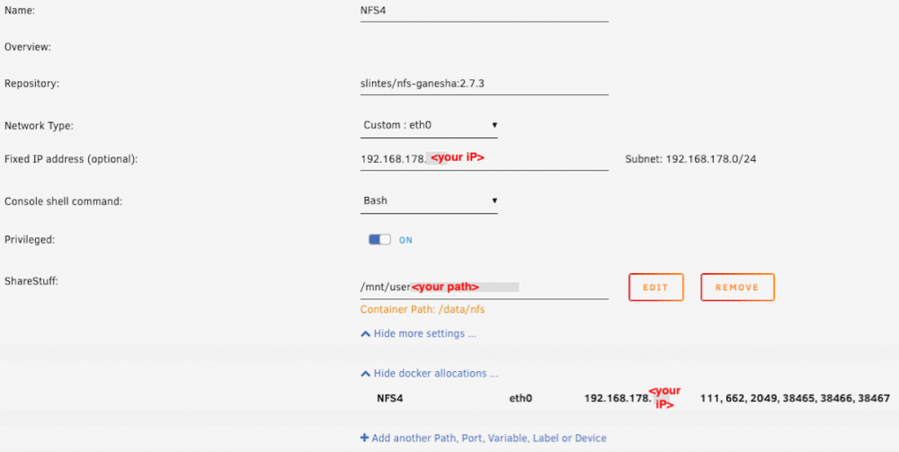

I installed a NFS-Ganesha container and can now provide NFS4. Technically it works and it solved the issues I had with NFS3. Nevertheless, it is a bolt-on, which is a work-around for something which should be provided by Unraid in the first place.
Hey. Could you provide some information on how you set this up? Do you disable NFS sharing on Unraid and instead have it be done via the container?
Hi Khadgar,
no, I kept the native Unraid NFS v3 share untouched.
I've installed the container with a custom Network Type (Custom: eth0) and set a Fixed IP address in the Unraid GUI. The new address must not be used by any other device in your subnet. The one I used is outside the DHCP range of the DHCP server, so collisions later on will be avoided.
