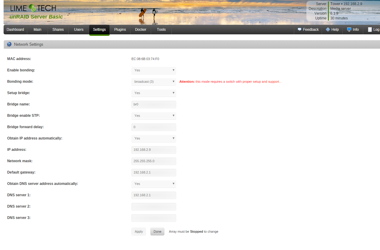

Sorry it took so long to work out. It looks like I have it working now. I ended up with the bonded "broadcast" mode. I now have a very healty green and orange flash on both nics in the server. When I patched my tv network to the "neighbors" network, I can still see the plex server and play a movie. All looks good. I will venture next door tomorrow and complete the plex setup on their tv's and report back. Thanks for all the help. If anyone needs any screenshots or logs let me know.
Great News! Both networks can now access the Plex server on the uNraid box. I will stress test today and report any problems.
Why don't you post up the screen shots of the 'Network Settings' and any other settings pages that you had to make adjustments on.  It could be most useful for the next user who wants to do a similar thing.

... Why don't you post up the screen shots of the 'Network Settings' and any other settings pages that you had to make adjustments on.  It could be most useful for the next user who wants to do a similar thing.

This would be VERY helpful for anyone else who wants to do this  :)

I don't understand why you think you need to have bonding enabled and especially in broadcast mode, since that simply transmits everything on both ports and isn't what you want. Why not simply configure eth0 so that it works with your own network and you have sole access to the Dynamix web GUI, and configure eth1 so that it works with your neighbour's network?
eth0 needs IP address, netmask, gateway and DNS server(s) settings compatible with your own Internet router - you could just set it to DHCP.
eth1 just needs an IP address and netmask that are compatible with your neighbour's LAN. You don't want it accessing the Internet via his router.
Perhaps you're trying to be too clever when it isn't really necessary?
Just upgraded server to 6.2 and now have the extra GUI config options. I have my network set as 192.168.2.1 w/ 255.255.255.0 sub. The neighbors is 192.168.1.1 with same sub. Is same sub a problem?
No, having the same subnet mask is not a problem.
I would not think bonding would help, as you which to have the unRAID server on two different networks.
The router/WAP/Wifi is often at the address of 192.168.x.1, so your server should have a different IP address. your screen shot has the server at 192.168.2.9, which is fine.
From house 1, you should be able to ping the unRAID server at 192.168.1.x(9?) and trying to ping 192.168.2.9 should be unreachable.
From house 2, the reverse should be true.

Thanks for all the help. I love UnRaid for many reasons but the community is one of the best parts. I can confirm now that I can access the server from both locations. I can view GUI and brows shares. After fiddling with Plex quite a bit, it now is working in "local" mode from both networks.
If you want to give back to the community, do a brief writeup on what was changed in plex, and the network settings in unraid, edit your first post with the short tutorial and change the title of your first post to something like, How to set up an unraid plex server to service to two separate LANs simultaneously, or something like that. The topic may not come up much, but since you earned the knowledge the hard way, it's yours to share if you wish.
