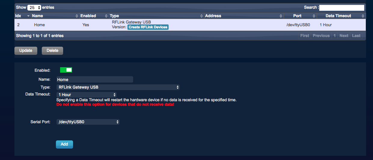

Has anyone managed to pass a usb device to the container?
i'm trying to pass an arduino using - - -device=/dev/bus/usb/001/005:/dev/ttyUSB0
dmesg | tail
[ 1298.319801] usb 1-1.1: USB disconnect, device number 3
[ 1303.099442] usb 1-1.1: new full-speed USB device number 5 using ehci-pci
lsusb
Bus 001 Device 005: ID 1a86:7523 QinHeng Electronics HL-340 USB-Serial adapter
docker exec -it domoticz lsusb
5a70eae90e4d6_ScreenShot2018-01-28at23_12_51.thumb.png.16b75982e9cbb39357830e34d4ff07bc.png
So looks like the arduino/rflink has been passed to the container ok but it wont ever pick up any sensors/devices.
I've tested it on a windows laptop and it worked fine.
any suggestions?
thanks

No point in mapping it to /dev/ttyUSB0 as it should be given that name in unraid if the correct module was loaded.
I replied in another thread to you to try running a modprobe command to load the correct module, but that didn't work?
To pass through a device to a container, it needs drivers in unraid. It's not enough that you see it when doing lsusb.
