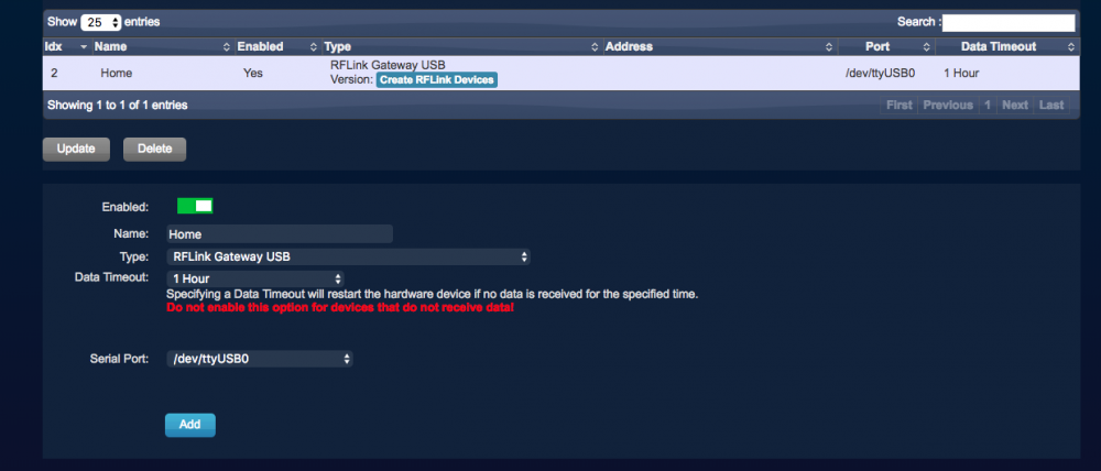

Is it possible to pass multiple USB devices through to Domoticz? I have my Z-Wave stick working but I would like my 433.92mhz transceiver as well if possible.
