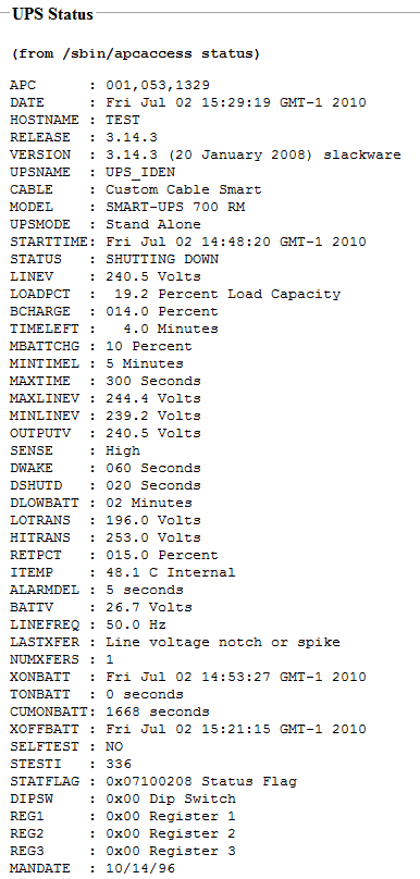

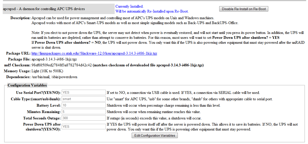

unRAID Test server failed to power down when the mains power to the UPS was turned off.
UPS = APC Smart UPS 700 (serial connection only)
unmenu 1.3
apcupsd-3.14.3-i486
unRAID Test server
unRAID Server Basic version: 4.5.4
AMD Athlon 64 Processor 3700+
2Gb Ram
ASUS A8N SLI Premium Motherboard
1 x SATA HDD 1Tb (Data drive)
unmenu 1.3
apcupsd-3.14.3-i486
unRAID Test server
2Gb Ram
Have you installed the powerdown package?  If there was anything running on the server that was keeping it busy it would have failed to shut down.  Install the powerdown package and try your test again.
Thank you for your prompt reply, would the powerdown package be "Clean Powerdown"? if so does it need to be configured in anyway?
Would constantly refreshing the UPS Status via unmenu stop the server from shutting down?

Yup, the "Clean Powerdown" package is the one that you want. and it does not need to be configured from what I remember (have not set it up lately myself, but it should be straight forward).
Yes
No
No

Yes, I did push "re-install on re-boot", rebooted, pushed "re-install on re-boot" a few more times, rebooted again...
The package manager told me that it "Will be automatically Re-Installed upon Re-Boot", and I believed it.  :)
fwiw, once I manually added that line to my 'go' script, it works like a champ.
