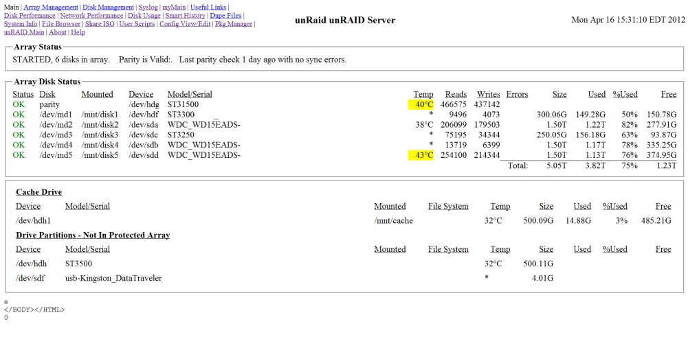

i have this wierd issue sometimes with unmenu that half the page doesnt load and just gives me an error on the bottom half
e
</BODY></HTML>
0
i cant seem to be able to search for this particular issue as it confuses te search bar i think and i admit i dunno the work around to search for these items
in the past only way to fix it was to reboot the server.

still seem to be getting this issue, not sure if it is unmenu related or not
e
</BODY></HTML>
0
