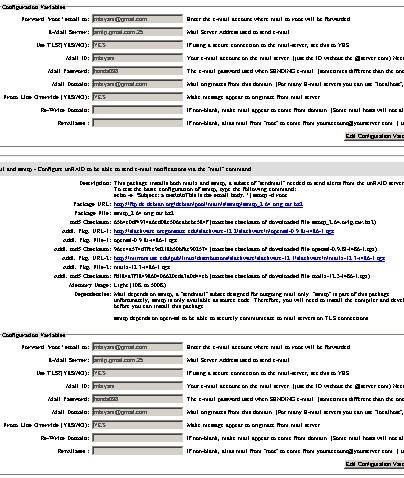

I have an issue when updating to ssmtp 2.64.
1.  I've updated the package from "check for unMenu updates"
It still shows 2.62 installed...
Then I select the 2.64
Attempt to "install 2.64..", says it is successful.  And it still reports I'm on 2.62.
Also, I have two instances of "configuration variables" and can select to install 2.64 from either..???
What are the commands I need to update properly? And remove the duplicate instances..Thanks!
to start clean, type
rm -r /boot/packages/ssmtp*
then, use the check for updates button on unMENU
You should only have one version at that point, the newer one.
Then, install/configure the newer version.
Thank you Joe.  Also had some ssmtp in /packages, as well as packages/ssmtp
ignore. solved.

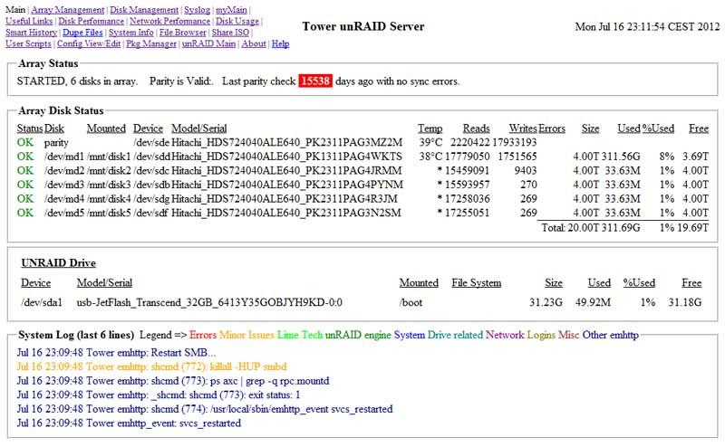

not sure if this has been talked about (as I can't seem to find it via search and i'm not reading 80 pages of posts, so sorry if it has been):
Under UnRaid 5rc4 - ESXi - pass-through of an M1015 works great, but unmenu doesn't read drive temps (where unraid has no issues getting drive temps).
Is there an easy fix?
unMENU uses "smartctl -a /dev/sdX"  to get drive temps.  What is the output on your drives?
Joe L.
Normal... when i modified any place in your code that still used '-d ata' it started to work.
I've clicked the download and update feature from unmenu, so should be on your latest code.
Joe L.

I've just configured my first unRAID server using 6 4TB disks. Now unMenu gives the following message:
"STARTED, 6 disks in array. Parity is Valid:  Last parity check 15538 days ago with no sync errors"
I've created the parity this morning, not 15538 day ago (which is a LONG time btw)... is the counter ok? Can i reset it somehow?

You say you created the parity this morning; now you need to run a check on it to verify that everything can be read properly. The counter is just saying you never checked the parity.
Ah ok, this references to the same stuff as the SimpleFeatures' scheduled parity check then?
Is that normal procedure, to check this right after you've just had it calculated?
Here is the configuration tutorial referencing to do a check after the parity is initially created:
http://lime-technology.com/wiki/index.php/Configuration_Tutorial#Adding_a_Parity_Drive_to_an_Existing_Array
After the initial parity calculation is complete, it is highly recommended to perform a manual parity check. This is to test you can read the parity data just written to the parity disk.
After the initial check is found to be good, I think most people will run a check once a month (yes, SimpleFeatures has this option). You can either schedule a parity check or do it manually.
