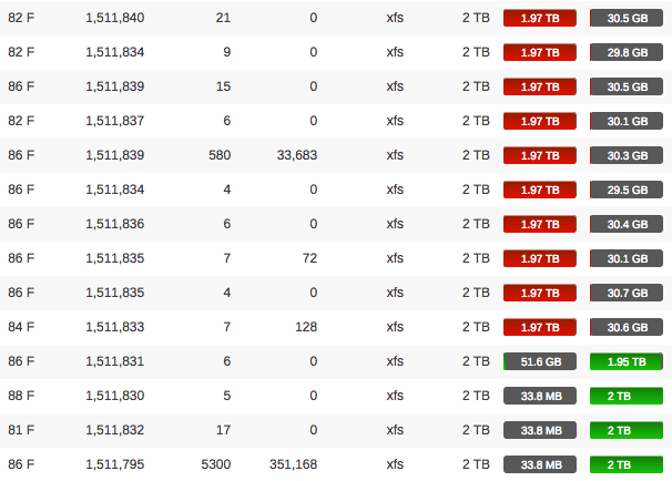

I have 2 disks failing.  One is full of data, the other is empty.  See screenshot.  I would like to remove the empty bad drive from the array without causing parity to need rebuilt - is that possible?  The goal is to be able to rebuild the drive that has data without the empty drive causing an issue that makes the rebuild fail.  Any suggestions?
I guess I should mention I had a power failure, and when unraid booted back up and started a parity check, these two drives are racking up the errors like mad.  Parity check is only at 30% and says it will take 72 days to complete... so I feel that at least one drive failing out is imminent.

I have 4 failing disks - the disks are old junk disks and a few read failures doesn't concern me, unraid handles that nicely.  But obviously 500K failures on a disk that's empty is no bueno - I want to eject that from the array, and replace the one that has data and has 30K errors.  The log leads me to believe it's a media failure and not a SATA cable.  I had to break up the diagnostics into 2 files because it was over the 320KB forum attachment limit.
Of the disks showing read errors 3 appear to be clearly bad, disk18 maybe all readable.
