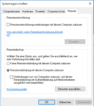

You might double check and make sure that "Allow remote connections to this computer" is still selected.
@Taddeusz This option is active (Sorry is a German screenshot) and it was possible for me to connect to the machine. But from today something might be changed (Windows update)?
It is also possible for me to connect from my laptop via remmina rdp client to connect to the virtual machine (Windows 10). But via guacamole docker image it is not possible for me. But on the other hand, it is possible to connect to a windows 7 virtual machine.
EDIT:
Ok I found the solution. The problem is that currently I get a certificate error at the login.
When I now activate the option to ignore the certificate the connection is working.
Thanks for your help.
Edited by fanningert
