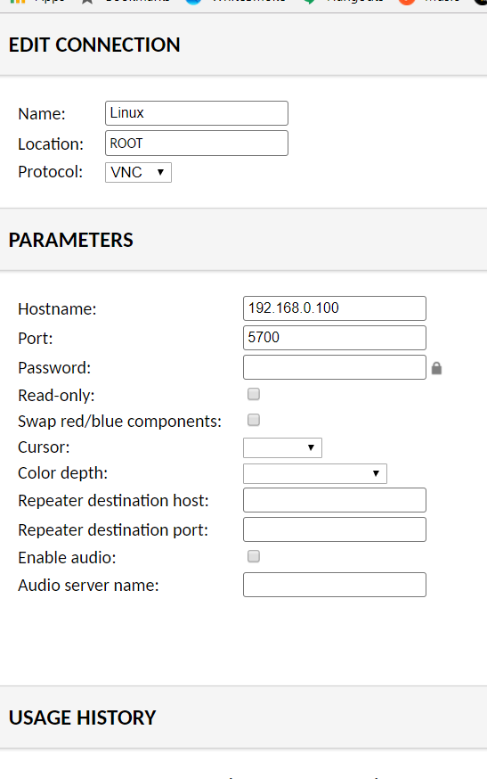

I have Guac installed and a Linux VM but for some reason guac cant access the VNC connection. i can vnc to linux but not through guac. I have also tried with and without a password. any ideas?
This works in Chorme
http://192.168.0.100/plugins/dynamix.vm.manager/vnc.html?autoconnect=true&host=192.168.0.100&port=5700&path=
Also, windows VNC viewer works
Guac config
host: 192.168.0.100
port: 5700
pass: blank
 docker logs 6e5c1dbf2353
Feb 19 12:10:32 6e5c1dbf2353 guacd[803]: VNC server closed connection
Feb 19 12:10:32 6e5c1dbf2353 guacd[803]: Unable to connect to VNC server.
Feb 19 12:10:32 6e5c1dbf2353 guacd[803]: Connection did not succeed: Error writing data to socket
Guac config
host: 192.168.0.100
port: 5700
pass: blank
Make sure you put your hostname and port under the "parameters" section. A few versions ago they added a "guacamole proxy parameters" section which confuses some people.
