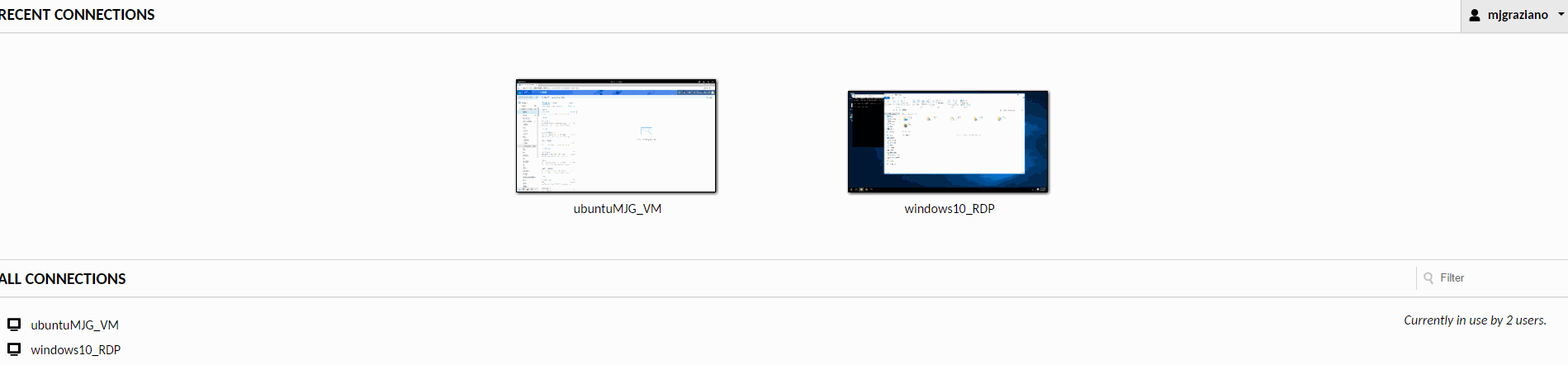

I've read through documentation, and through this thread.  Can't find a resolution to my infinite login loop.
If I'm at the screen of my VM through Guacamole, I hit CTRL+ALT+SHIFT.  On the top right, at the username, I have three options.  Disconnect, Settings & Logout.
1. Disconnect: - Creates a new popup with two options to reconnect or logout.  If I reconnect I log back in.  If I logout it automatically reconnects me.
2. Settings - I'm logged in as a non admin user.  I can cahnge a few things like language and input method.  On the top right is my username.  I have the option of my VM which takes me back to my VM.  I also have the option to logout, which logs me out and auto reconnects me.
3. Logout - You guessed it!  This one logs me out, and then auto logs me back in.
This perpetual loop is maddening!  I've tried incognito mode to make sure it's not a cookie issue.  No good.
While typing this out, I just tried to log in with my local IP rather than my domain name and I got the guacamole apache main login screen.
Any idea how to fix this loop externally?

As nice as Guacamole is this is one of the things that bothers me about it. They designed it so that if there is only one connection configured it will automatically connect to it as well as reconnect to it. The only way out of that situation is to go to the settings and create a second connection. Once there is more than one connection configured it will go to the selection screen upon login and when you want to disconnect you will then have a "Home" option that wasn't available before.
I believe the reason they have it configured this way is for single application situations like in a Docker container. The one example I have that I use frequently is the HandBrake Docker. It uses Guacamole internal to the container to connect to the X session to display the HandBrake GUI. It's the only connection available so it automatically connects and is the only connection ever available within the Docker.
So, just add a second connection and it will solve your frustration.

I wish this worked for me, but unfortunately I have two users and two connections and I'm still auto connected upon a disconnect
Do both users have permission for both connections? If they only have permission for one connection each that's still just one connection.
Bingo.  So I basically have to make a dummy connection so that there's no forced reconnect?

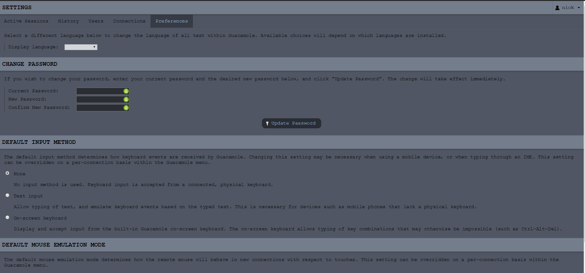

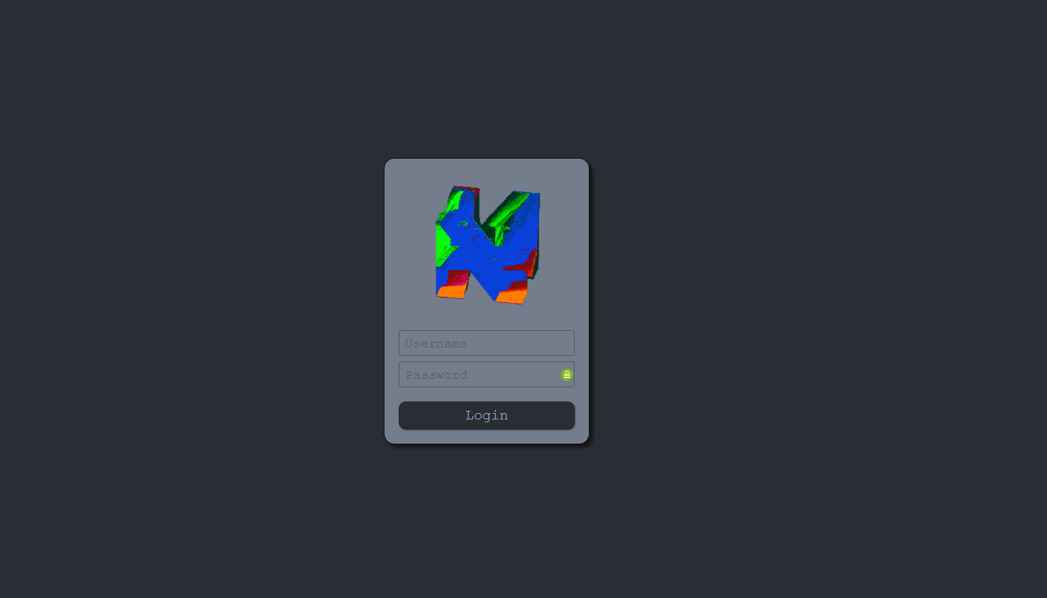

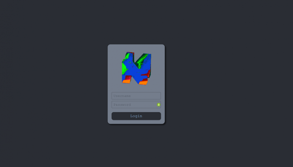

I figured out my extension issue... it was unrelated to the container.  I did want to share the jar here though... it is a minimalist dark skinned theme using the guac-ext guide here:
https://guacamole.incubator.apache.org/doc/gug/guacamole-ext.html
Just place the jar in appdata/ApacheGuacamole/guacamole/extensions and recreate the container.
This extension only does the following:
inject custom css overlay
injects 3 custom logo.png files to replace stock guacamole logo on login screen, in the UI, and on browser tab
modify the en.json language library to change the application name from "Apache Guacamole" to ""
Let me know if you are interested in customizing the skin - I am working on creating a tutorial.
generic-customize-extension.jar
