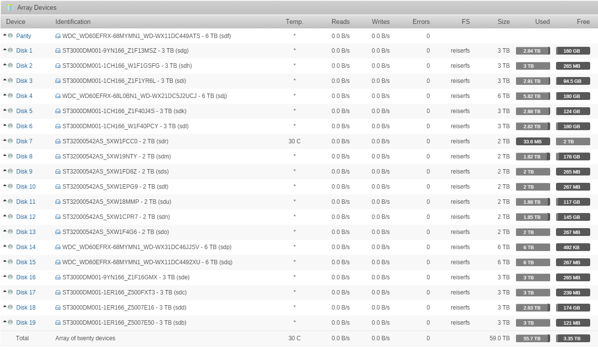

Hello, i've looked around but can't seem to find an answer to my scenario.
I've decided to start converting to XFS from REISER FS. I currently have  emptied a 2TB drive ( drive 7 in my array). I have  6tB to replace it ( i want to format it to XFS) to use as my first drive to dump data from another 6TB Reiserfs Drive.
how do i proceed?
I don't want unraid to rebuild the drive ( since there is nothing on it), any advice out there?
Thanks
Nick
Edited by nicolasg
added drive assignments
