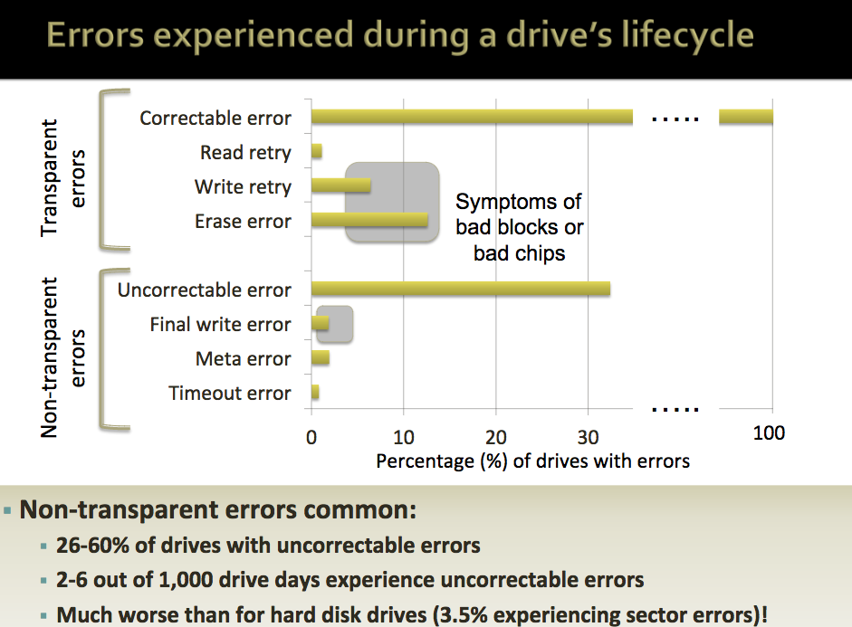

Unfortunately, I do see drives returning corrupt data on a regular basis. Enterprise storage manufacturers actually fight over who does this better. Enterprise storage uses drives which offer variable (512/520/524/528 bytes per sector) configurations for additional checksum storage. They don't do this just because they want you to buy more drives.

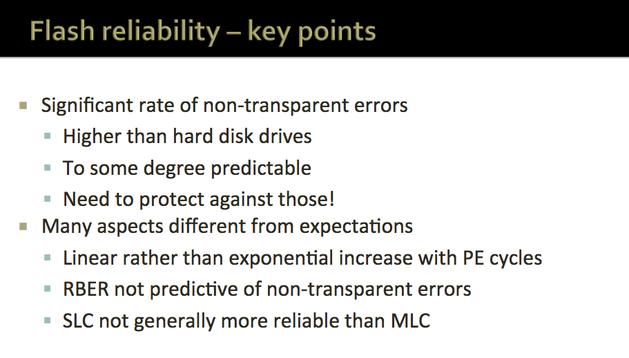

additional sources
It is interesting if (when?) we see a transition from spinners to solid state drives for disk arrays, that we may start to see more of this type of corruption occurring. It's not bitrot, but maybe the digital equivalent. BUT, I have to believe that in a world where accurate data is mandatory, we unRAIDers with our media servers are not the ones leading the charge. Although it may be true (not doubting c3) that data accuracy is an issue even with today's drives, UhClem's "untrue!" comment is the de facto understanding approaching fact. Bottom line, I have a high degree of confidence this will get sorted out if it has not already.
Of note, and I think this is a reality, typical spinner drive behavior of sectors slowly "wearing out" but maintaining ability to read with multiple retries (sometimes resorting to putting drives in the freezer) will be moving towards a binary state - either readable or not. This will make lives more complicated, especially for our users who occasionally poke themselves in the eye trying to recover, and wind up relying on a failing drive being largely readable as a safety net.
While everyone wants to talk about Annual Failure Rate (AFR), there are plenty of other measures, some more important depending on how the device is used. SSDs have a lower AFR than HDD. SSDs also have higher uncorrected errors. This means SSDs lose data more often, but keep working. You can read the study from last year.
Many years ago the BER number from drive manufacturers were confirmed by CERN. Pretty much everyone agrees, there is no guarantee that data will be written and read without corruption. CERN found 500 errors in reading 5x10^15 bits.
"Silent data corruption is an unrecognized threat that may affect as many as 1 in 90 SATA drives." from NEC as an enterprise storage provider.

UDE is a larger set of conditions, especially when talking spinning rust. You can see where TDMR will help.
To improve the chance of avoid anything that might have my ideas, work, or decisions; use Microsoft products, but only the newer filesystems.
In other news, quietly slipped into unRAID 6.3.2 was f2fs. Which is very exciting (or worrisome), especially post 4.10, probably the next roll of unRAID. f2fs now has SMR support (took 2 years). But the stuff I work on takes a long time to do and even longer to get rid of.  SMR is just the beginning, but the whole concept of decoupling the write head from the read head/track width was fundamental to driving density. Other filesystems will follow, and/or use dm-zoned. Doing so will have benefits for flash write durability. Best of luck avoiding.
But things like filesystem checksum will be needed outside the spinning rust world, and the OP is probably grateful.
Edited by c3
