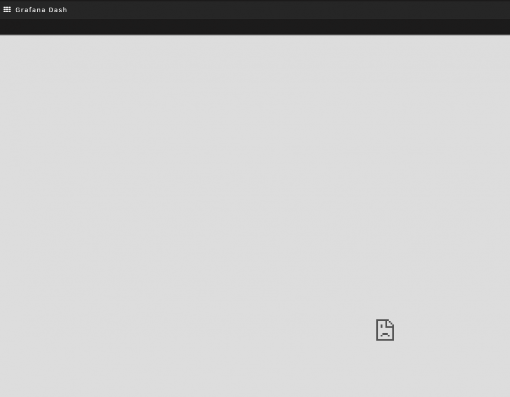

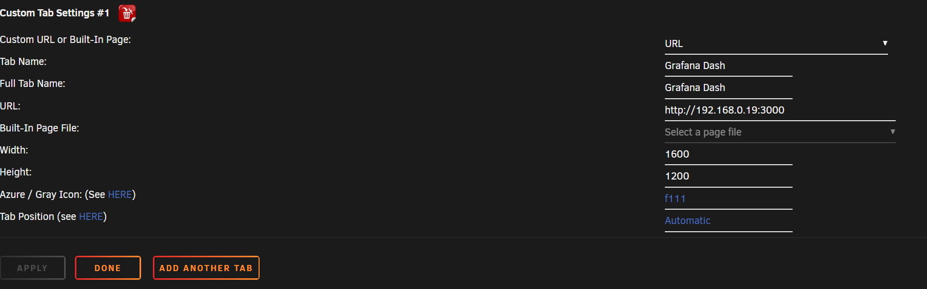

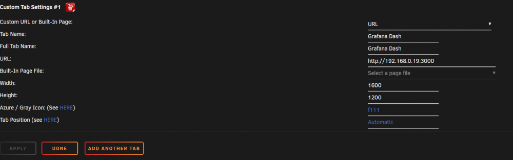

Hey Squid...I'm trying to have a custom tab point to my grafana dash.  Server is NOT accessed via HTTPS.  I add the tab, have it go to the URL, save, when I try to go I get this:
This is the URL in question: http://<serverip>:3000/d/000000001/unraid-system-dashboard?orgId=1&refresh=30s
Works fine when put into a browser tab on any browser on my system.
Any thoughts?
I would just go with http://<serverip>:3000 and then see if that works
Just tried that:
Get the same white box.

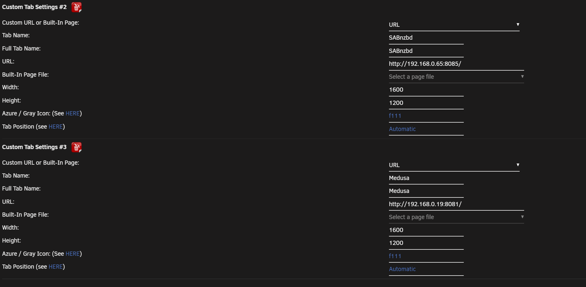

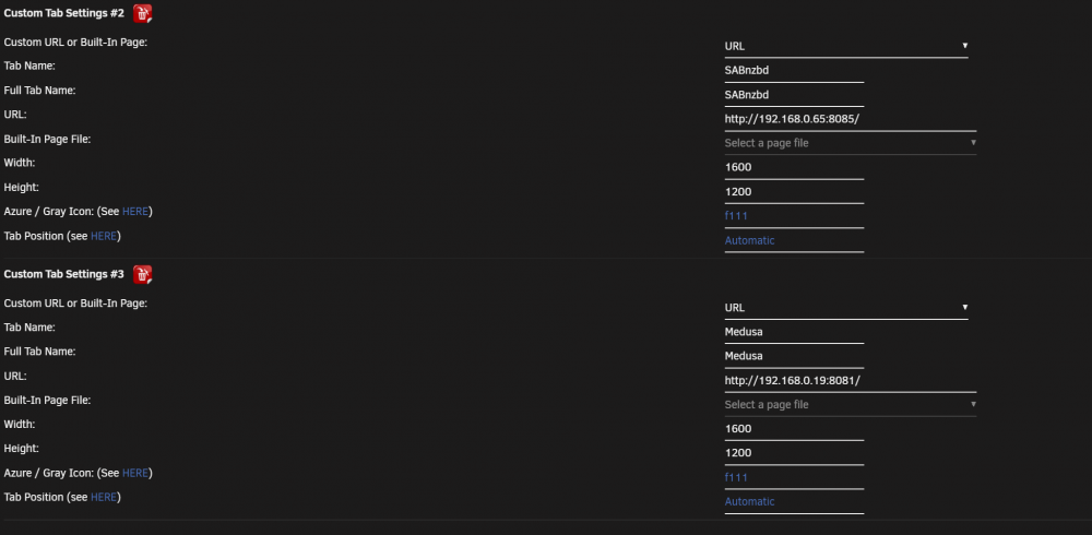

Getting the same type of thing when using a URL to my SABnzbd docker (http://192.168.0.19/SABnzbd)
But it's working properly with my Medusa docker (http://192.168.0.19/Medusa)
Has to have something to do with the reverse proxy you're using.  Not able to help with that unfortunately.
im not using a reverse proxy.  this is all internal traffic only
You're doing something, because that is not a URL to the stock SabNZBD  You would normally specify a port.
Apologies - I just right clicked on the link in the bar in the dash.  Here's the config from the plugin showing there's a port (medusa also has a port as you see and it works - which is working as mentioned earlier):
Quick note - the 192.168.0.65 is an internal IP on my network - and is actually a VM running on unraid - could it be some weird networking issue within unraid preventing it from communicating?  0.19 is the ip of the server.  The server does have a default gateway set to 0.1 (my router)...hmmm....
I can get to it without issue from other computers, my phone, etc, all on the same network.
Probably you're getting nailed by a cross-site security provision enforced by the browsers which won't allow scripts from one domain to be executed on another.  Depends upon how the remote site is actually programmed as to whether this trips the blocking.

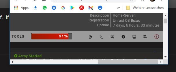

hi,
i've got a problem, when i shrink the browser windows. the buttons on the right disappears, while i am using custom tabs
Expected behaviour, and built into the OS itself.  If there isn't space for them, it won't display them
if i delete all custom tabs, i can shrink the window and all icon are still displayed. maybe there is a way that custom tabs are like the "normal" unraid tabs?
They are normal unraid tabs.  The behaviour is from the buttons.  If there isn't room the OS won't display them.  You can gain more space by not displaying the array usage bar.
