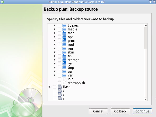

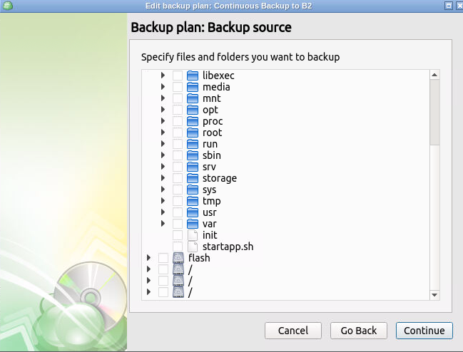

@Djoss I see a ton of "/" locations in the file selection window. None of them have subdirectories.
Is this normal?
9 hours ago, Djoss said:
I guess not, do you have a screenshot?
One with all / closed. One with top / open. One with top / open and bottom /'s all clicked on once (on the exposure triangles) to show that they're empty.
Finally I also have the same thing...  I will try to see if I can remove the last three "/".

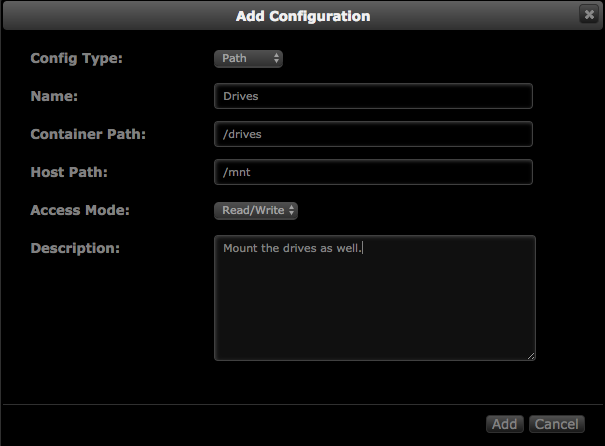

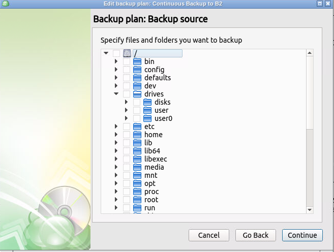

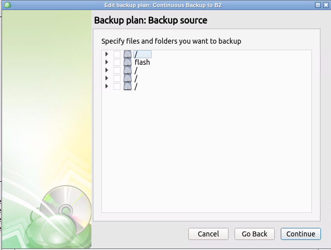

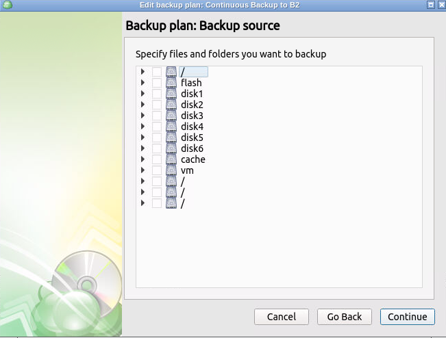

It gets weirder. If I map in unRAID's /mnt rather than /mnt/user for /storage, or as you can see in the screenshots below: if I map in unRAID's /mnt into a different container directory, all the drives show up at the highest level of the list and not in the correct spot in the container hierarchy. It's weird, I tell ya. I haven't seen that happen in any other dockers.
The problem seems to be with the way CloudBerry Backup handles mounts inside the container.  I've opened a case with their support team.
During this time, you can just ignore extra "/" locations.
