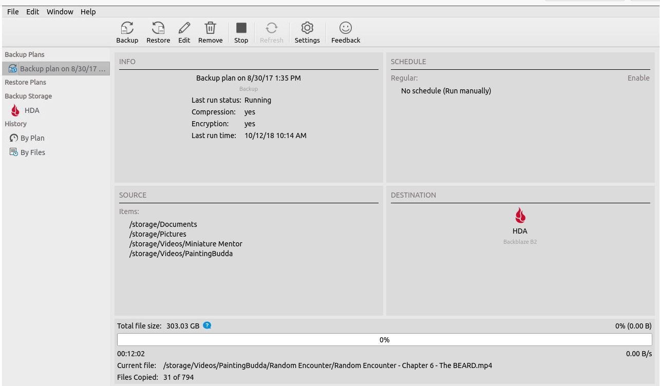

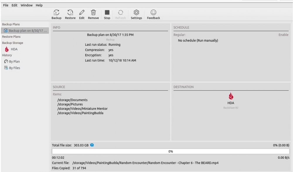

I just updated to the latest version and am starting a backup and do not see any upload going on. I have attached a console screenshot but I am not sure what logs to attach. I can't seem to find what I consider the true CloudBerry Application log that shows anything that might be relevant in appdata/CoudBerryBackup/Logs.
Any idea what logs to look at or where to start?
I have unraid 6.6.0 running also
In log_worker_xxxxxx.log I do see the below error:
2018-10-12 11:04:28,351590 [WARN ]: [ CBB ] [ 1 ] Error on exec sql query: database text: database is locked driver text: Unable to fetch row error code: 5
I went ahead and re-installed the docker. I think it was a sync issue. Just for reference on how I re-installed:
1. Release the license in CloudBerry
2. Remove the docker container
3. Deleted the /mnt/user/appdata/CloudBerryBackup folder
