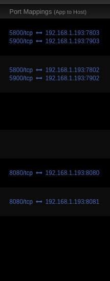

I don't think this is a "real" issue. I changed my port mappings for one of my 2 dockers of cloud berry to I could run them at the same time, and about a week or so later, fix common problems complained about this:
Docker Application Backup_Remote, Container Port 43210 not found or changed on installed application
When changing ports on a docker container, you should only ever modify the HOST port, as the application in question will expect the container port to remain the same as what the template author dictated. Fix this here:
Application Support Thread
Docker Application Backup_Remote, Container Port 43211 not found or changed on installed application
but the ports I changed were for webport and vnc
backup_remote 7803 7903
backup_local 7802 7902
so....????
so....????
What are you port mappings, as displayed under the Docker page?
59c6d71f4adc1_ScreenShot2017-09-23at5_49_22PM.png.6817c1be3adcb571093583a1a788b3fd.png
top 2 are both cloudberry instances. bottom 2 are 2 Krusader instances.
Did you removed mappings to ports 43210 and 43211?
nope, never had anything assigned there, which is why i'm confused.
They are new ports added since the latest version.  Normally, the template should automatically update itself and add them...
