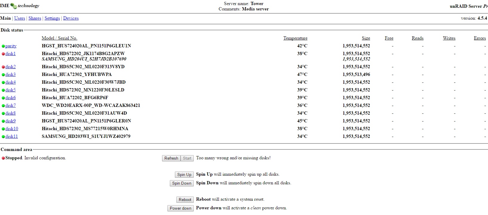

I relocated my old Unraid server that had several disks as old as 2011 with over 20,000 hours on them. The new location was warmer then the old location and I had two drives fail. One completely dead. The other shows life on smart but red ball on main page. I added a new drive to replace completely dead one but cannot start array. Any way to get the second drive with some life back online?

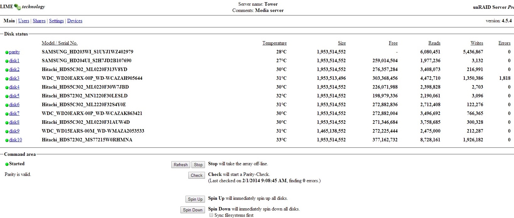

Before crash..

8 hours ago, kciaccio said:
Before crash..
Not a screenshot. Do you have a backup of the flash drive?
The system is showing Drive 1 as the "wrong" drive and is showing Drive 2 as red-balled/failed.   The "before failure" picture shows a lot of errors with Disk 3.
So ... WHICH drive(s) had red-balled BEFORE you decided to replace a drive?    If you had 2 red-balled disks, then it's very unlikely you can rebuild either of them unless one is actually good and was just a cabling issue ... but from what you've shown above it's not at all clear which disks had failed and which one you're referring to as potentially still good.    In addition, unless you have a backup of the exact flash drive contents from before the failure, it's unlikely you can reconstitute the array to a position that will allow you to attempt a rebuild.

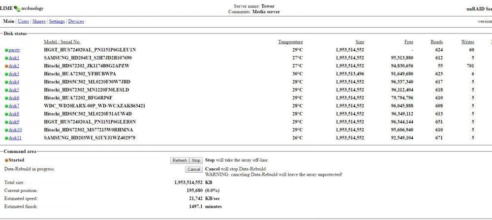

Drive 2 failed first. I have a second server that I built a year ago that I did windows 8 storage because it just flowed better for a plex server. It has about 80% of what I had on my UNRAID server.
I will see if I can read from either of the drives..Thanks for the program!
Just used your program an I can see and play the files on the one disk.
Edited by kciaccio

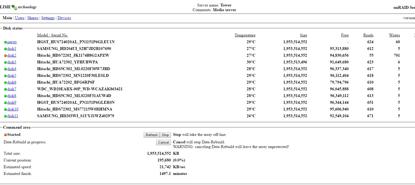

Plugged back in cross your fingers and pray!
The rebuild is going a bit slow, but as long as it stays consistent I'd just let it finish and hope all works out okay.   One thing you COULD have done [Actually still could, but I'd be inclined not to use the array during the rebuild], was to "look" at the contents of disk2 and see if they looked okay.   You wouldn't REALLY be looking at disk2 ... you'd see the emulated contents reconstructed from all of the other disks ... in other words exactly what's now being written to the new disk as the system rebuilds disk2.
But since it's already underway, I'd just wait a day or two until it finishes - then look at the data and see if it seems okay.   If you have backups of SOME of the files, I'd do a binary comparison of those to confirm they're okay -- if so, that's a fairly good indication that you have a successful rebuild.
When you start an array with one disk down, that disk is emulated (by parity and all of the other disks). But from user perspective, that disk is present. You can see all of the files as though the disk were present. In theory you can ever write to the array (although I do not recommend it). At the very least, I always recommend at least checking this before doing a rebuild. Because what is getting emulated is what will be rebuilt. And if it is garbage, there is no need to proceed.
But for older arrays especially, instead of doing a rebuild, I recommend the user copy the files that are most important to a safe location, and gradually move to the lesser important files. The benefit of this is that, as files are copied, you know that those files are completely restored. With a disk rebuild, once it completes successfully, the entire volume would be present and all files intact. But if one of the other disks in the array were to fail in the middle, you'd have a half reconstructed disk. Since unRAID rebuilds sector by sector, with no concept of a "file", you'd have no way to know which files were completely restored, which were partially restored, and which were fully restored. It would be take forever to sort out with a bunch of content.
Fingers crossed for you! With a little luck all will restore and you'll be in good shape. I posted the above mostly for future readers to understand (what I think is a better) alternative.
Good luck!
I would not only have copied the files from the emulated disk; but also from the "good" disk that could be "seen" okay with LinuxReader ... since, based on the earlier "failure" of that drive; that's probably the most likely drive to fail during the rebuild.
But as I noted above, since the rebuild is already in progress, I'd simply let it proceed -- no need to add any additional "stress" on any of these drives.
