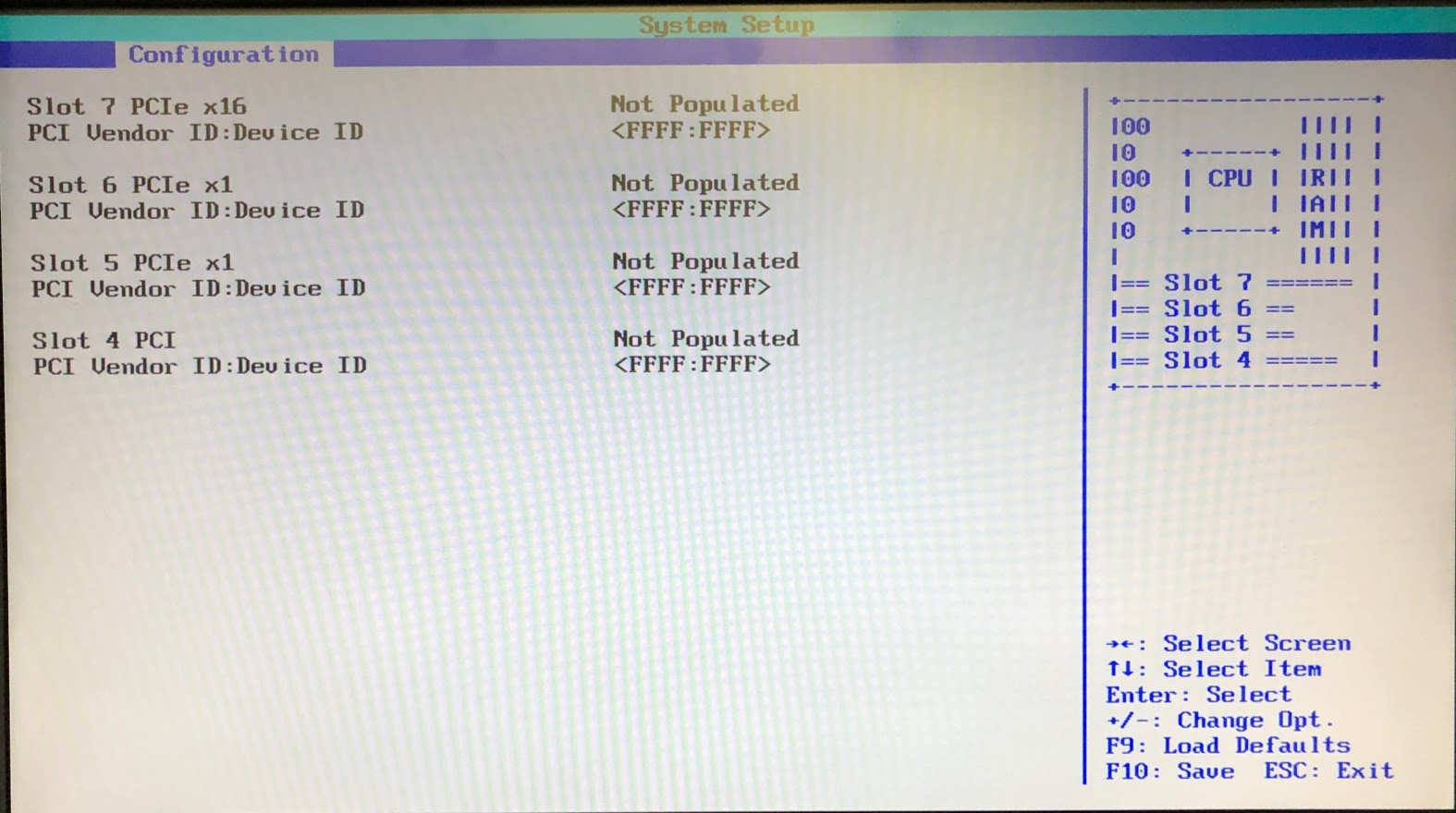

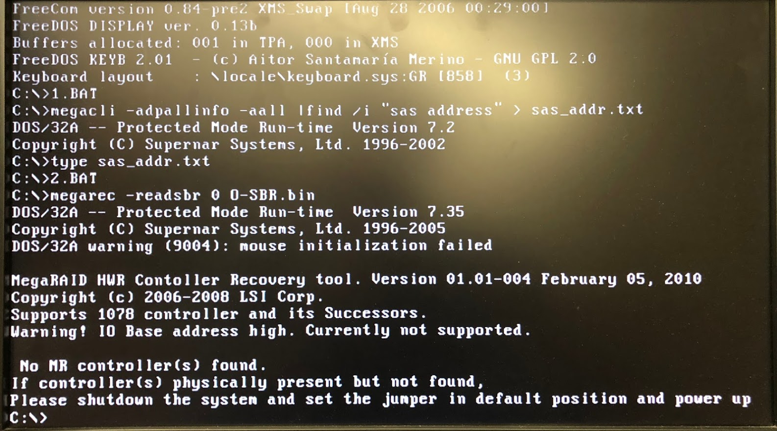

Maybe someone can help me with a strange issue I have: I ordered Fujitsu D2607 from ebay for $20. It already came with IT mode enabled.
Put it into my PC and could enter the card's bios and see attached disks. I then set the card's BIOS to DISABLE so there would no interference during boot and the card would work as sole HBA only.
I played around a little bit, removed the card from the PC and put it in another PC. Turned it one, and NO CARD was seen be the bios. The bios shows the PCI slot as EMPTY.
Put the card back into the first PC, and I can't see the card there neither.
Any idea what I can do? Maybe the card was destroyed by electrostatic?

Thanks. Hopefully the card get's recognized somehow. I find it strange that it's NOT SEEN in bios. Does this look reasonable to you? Maybe because the card is somehow not initialised/booted internally?!? I need to get back home to try, so it may take some time to get results.
I believe messing with the BIOS rom can have this effect.
the meagrec cli command in the dos environment may still see the card.
I guess I'm out of luck. The card is just not recognized:
image.thumb.png.f9d6b6ba8f1b01b610e40249b40ee633.pngimage.thumb.png.04269905ce0014d0db69867e6f934040.png
Hmm does look like you've broken.. it which isn't good.
At least the card isn't too expensive.

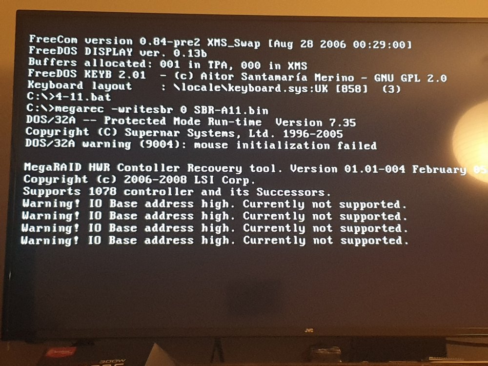

I've tried the batch scripts provided in the second post on my D2607 A11 without any luck.
Every time only one port is working.
I have 5 drives connected with 2 breakout cables. And have swapped around the drives, cables and ports on the HBA without any success so I've eliminated the possibility it could be the drives, cables or that one port on the HBA might be defective.
I've also previously tested all drives in an external USB enclosure for functionality.
I've also tried flashing an SBR with the "04" changed to "07" and "00" without success. (I made sure to adjust the checksum)
Also tried "sbrfj.bin" from marcan.
Due to my mistake I've lost the original SBR unfortunately.
I've also tried a H200 SBR without success.
Any suggestions that could help me?

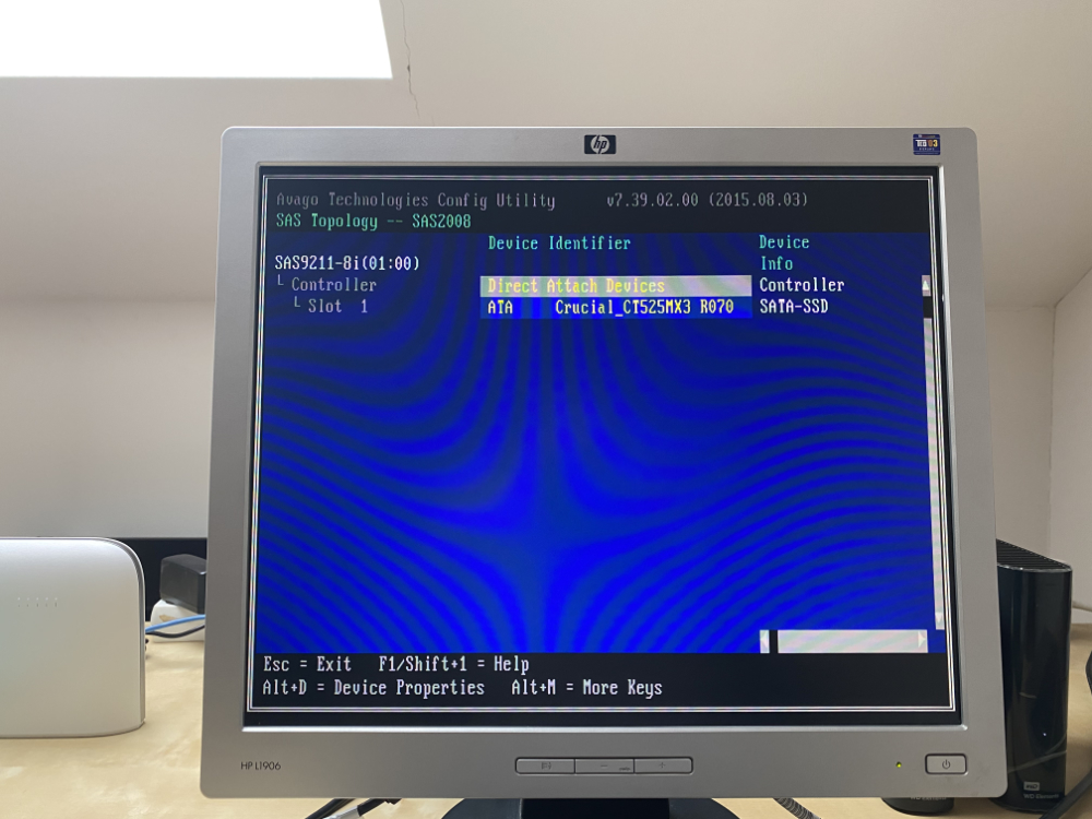

Now that is strange, so both ports work but not at the same time... that's not how it went doing my testing and with the cards I was testing (I flashed 13 in total)... Only one out of the two SAS ports would ever work.  Wonder if something has changed with the newer versions of these D2607 cards.
How many disks are recognised by the BIOS utility for the adapter (Press F2 thingy on the megaraid thingy)? when you have both cables populated?
Edited by Jonny
I don't know what you mean by that. It goes from the AMIBIOS screen directly to dmesg messages without any screen in between where i could press F2.
Ah I think you may not be getting the screen cause your OS is booting in UEFI mode, change it over to CSM/BIOS mode, you should then get a BIOS post screen for the card.
This isn't the exact screen but its very similar.
Here are the screens. Only 4 drives detected.
Edited by LsHallo

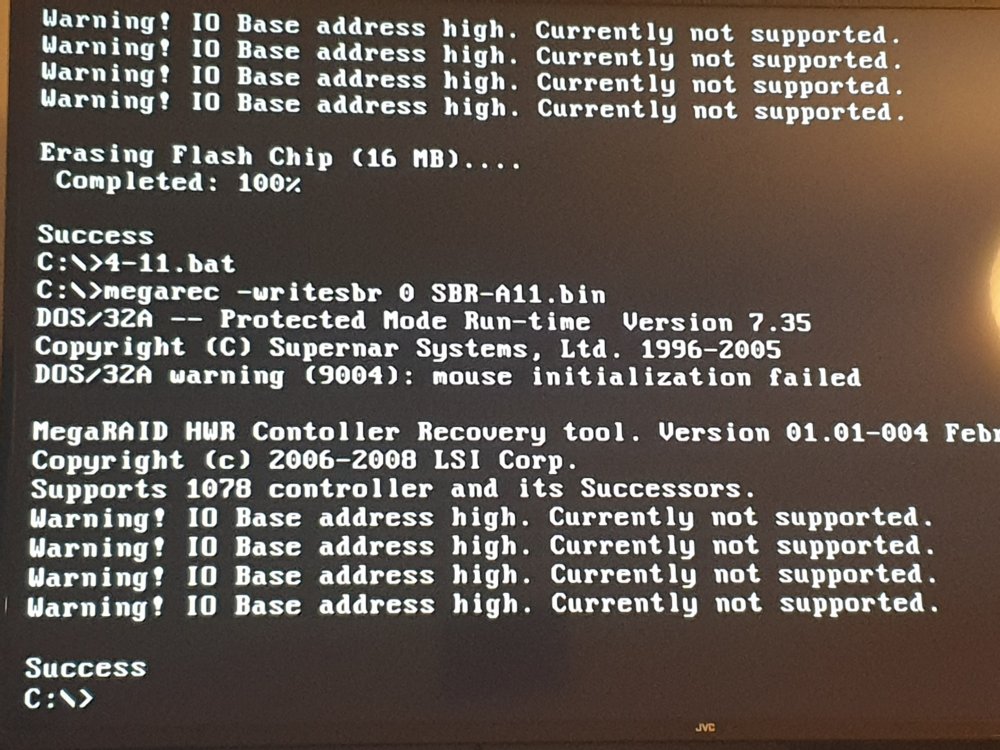

I just found my old USB I used to flash these cards and I had an original SBR on it. It has a slightly different "PCI Vendor and Product ID". So I've patched it and done the 3 versions of it with the magic bit changed.
See how these go.
try2.sbrtry1.sbrtry3.sbr
I hope it was correct to just to megarec -writesbr 0 tryx.sbr.
If so neither of the three brought anything up. The startup window with CTRL-C to enter menu disappeared completely and ubuntu had a hard time booting and multiple things timed out. Same behaviour showed when shutting down. Some processes just would not finish. Particularly "udev".
Seems I don't have any luck with my card...
Any more sbr i can put on there?
Yeah that's correct just run that command in the FreeDOS environment.
