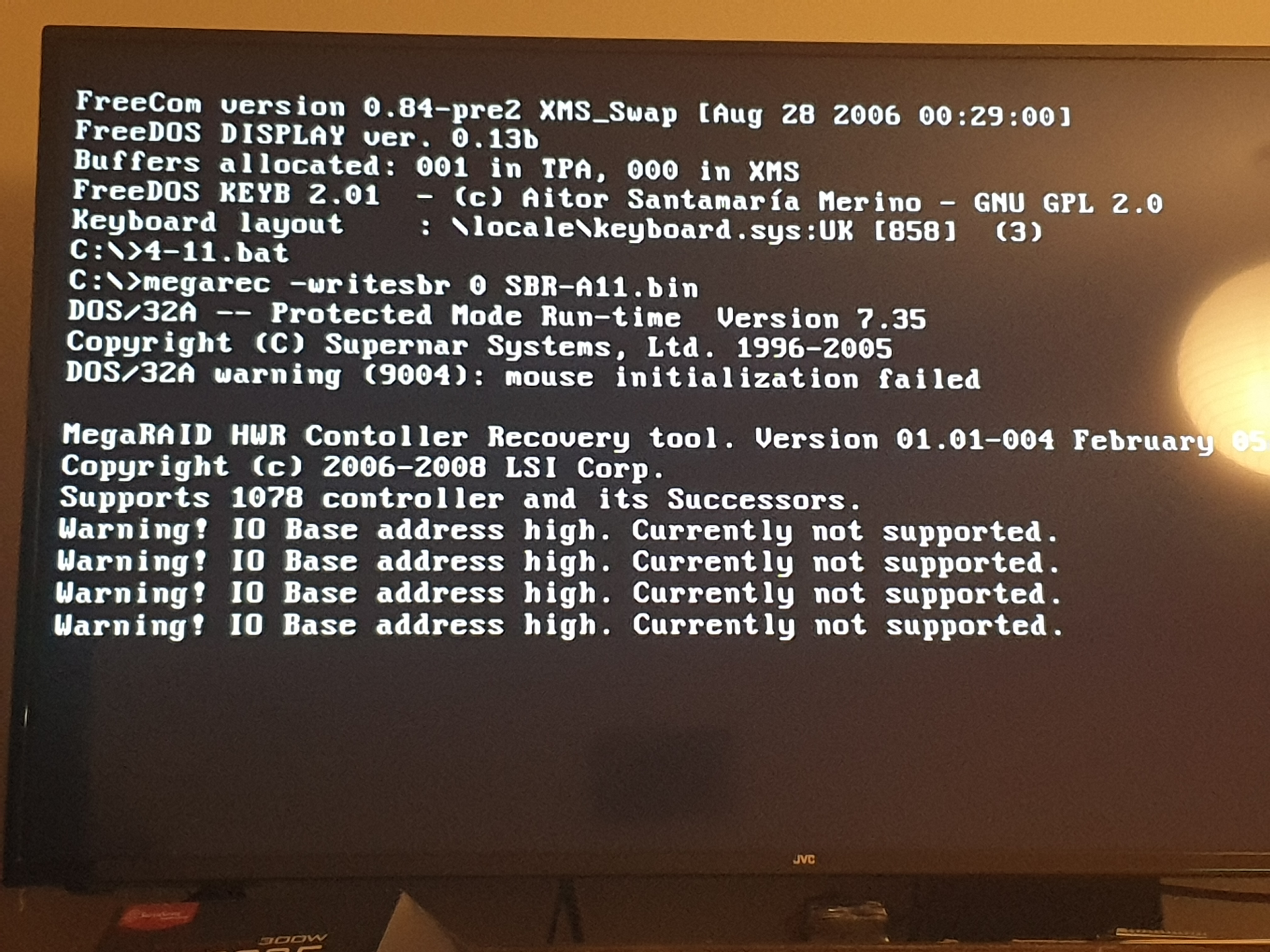

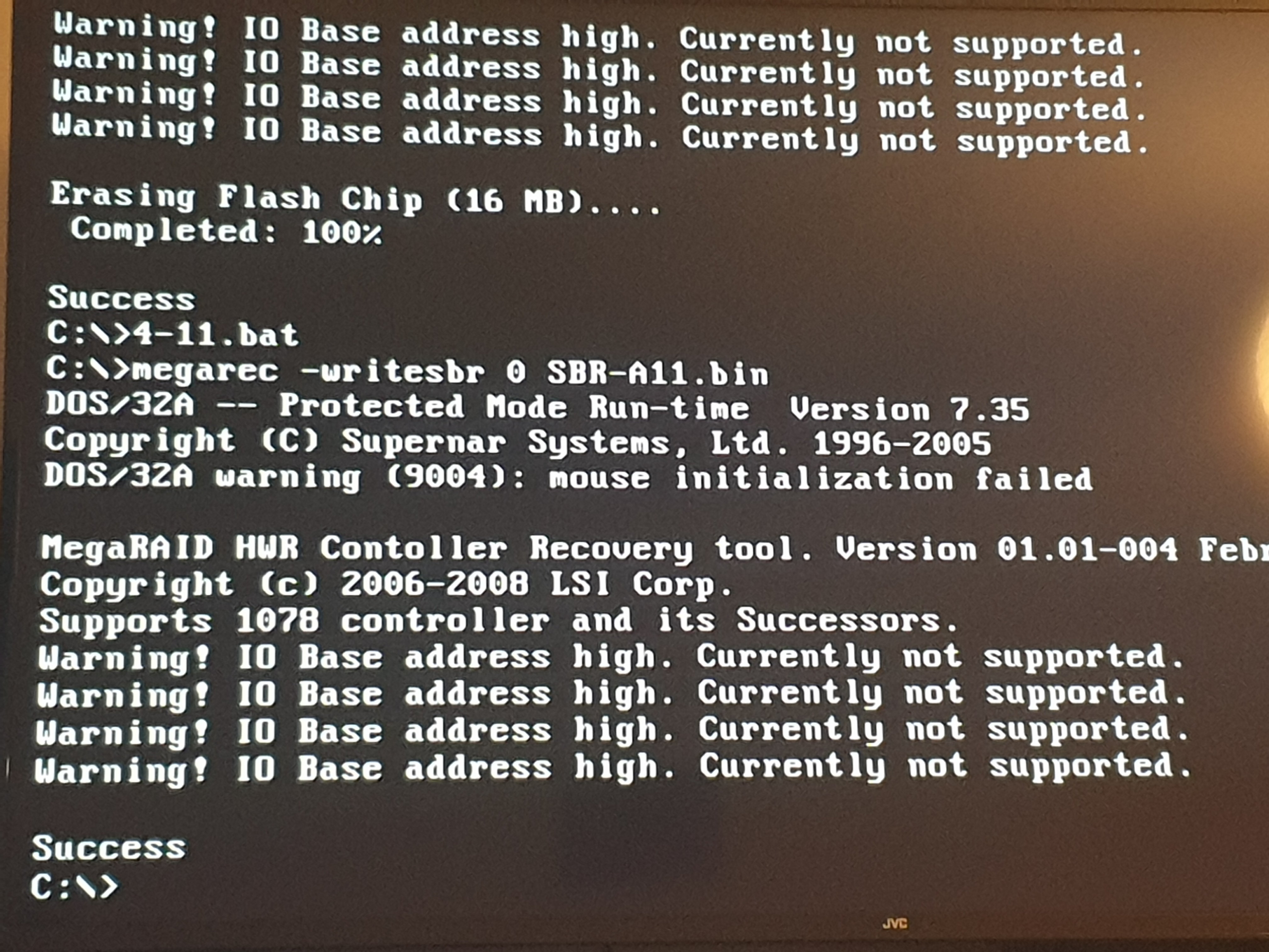

When in dos and flashing i get "Warning! IO Base address high. Currently not supported."
I was getting that originally aswell but each section finished with "success"
Is that okay?

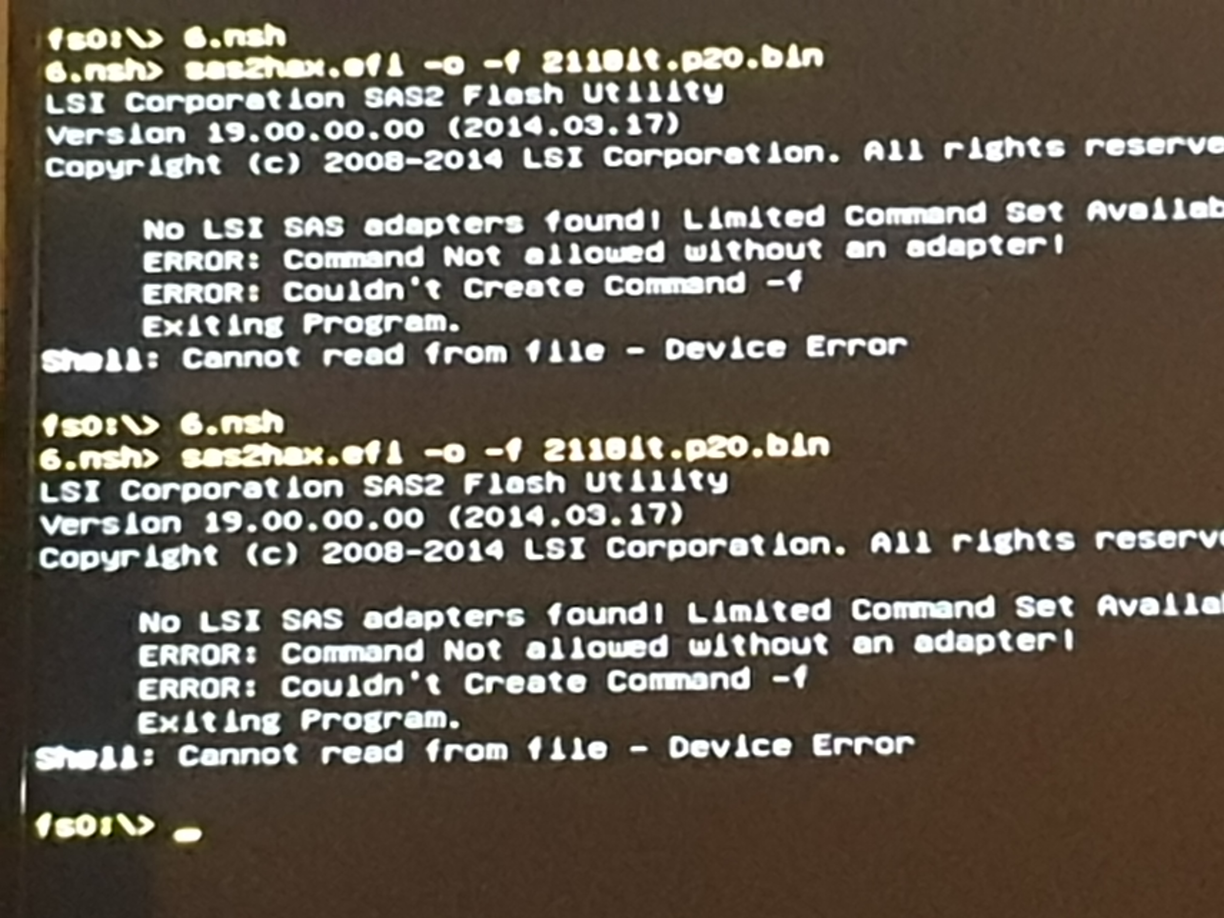

20 minutes trying to get the pc to boot and i get this
Oh wait...
It's still detected in dos.
Wtf.
Edited by mdrodge
Then dos started to hang on 2.bat or 4-11.bat.
I guess it died.
This makes no sense.
