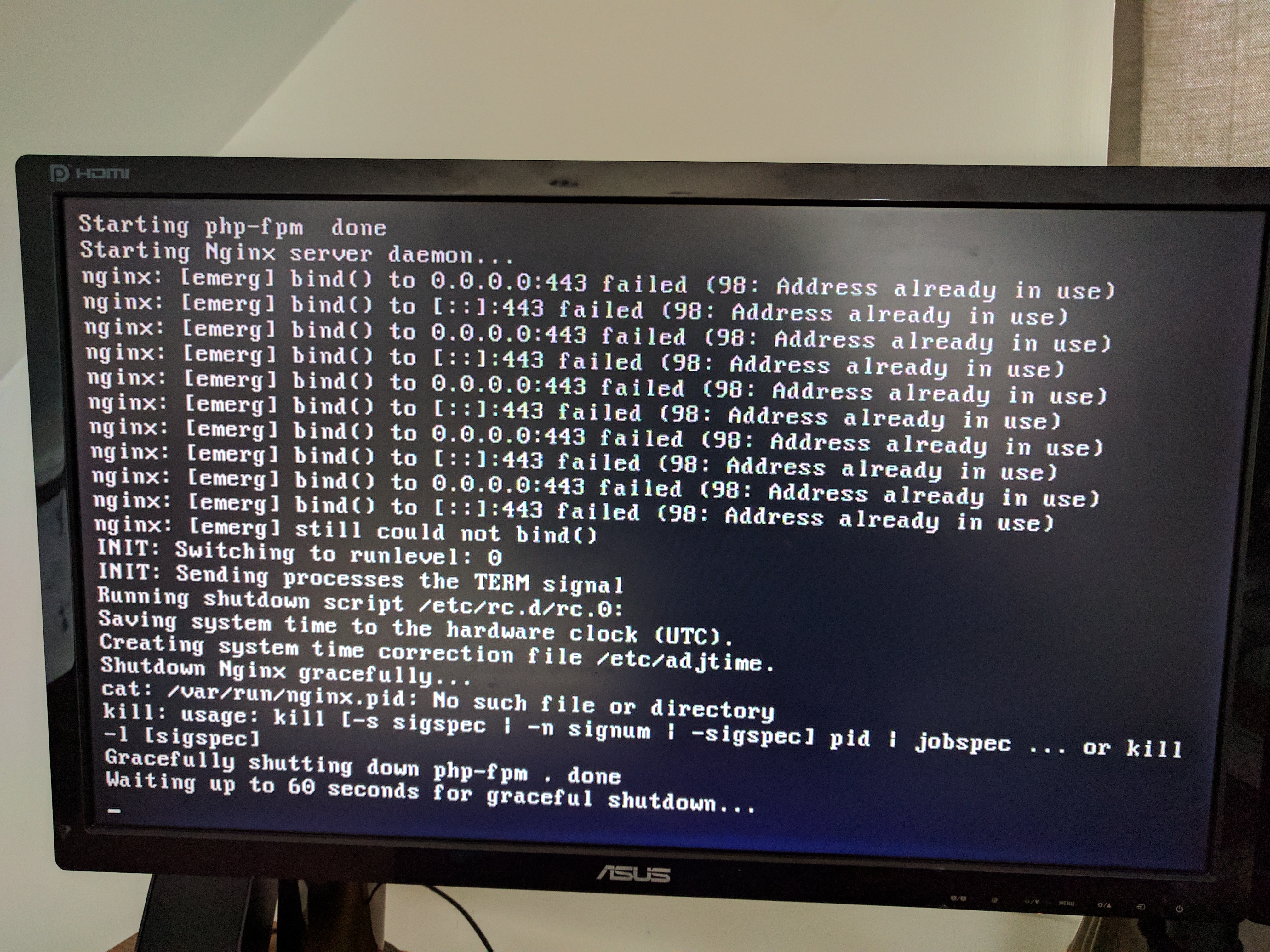

I run a pfsense VM (172.30.12.1) which is connected to my modem (192.168.1.254) and all my devices get 172.30.12.xx addresses from pfsense, including unRAID which has a static 172.30.12.x IP address
Pre 6.4, when unRAID booted it would get in a bit of a muddle because it's looking for the 172.30.12.1 gateway via the VM which isn't available yet, but eventually it and dockers would 'give up' and then the pfsense VM would load and all would be fine after about 15 mins.
With 6.4, I don't think unRAID is happy with there being no internet connection and gets stuck at this step:
I waited over 30 mins, tried again and had the same problem so I've rolled back to 6.3.5.  Unless this is fixed, I don't think I can use 6.4 and pfsense at the same time - a lot of users seem to be using pfsense as well, so I think they'll have similar problems

personally I read that log as something has already used port 443 prior to unraid UI attaching to it.
Do you access any services(plugins, dockers, VMs) on unraid using https on port 443.
Also if this really is a case of unraid wanting the IP set before the VM starts up, why not apply the static IP on unraid instead of a static DHCP lease?
see
Edited by Tuftuf
Port 443 is used by nginx by default. You have a port collission and need to change either nginx (see go file) or your dockers.
Doing pfsense on unRAID in a VM can lead to a catch 22 situation, my personal preference is to use a separate appliance as firewall.
ahh thanks - I've got letsencrypt running on 443

I understand the reason of your request, though the simple solution is to NOT autostart the 'offending' container(s)
Port 443 collisions are going to be a big problem when everyone starts upgrading. Would it be possible for unRAID to detect that nginx couldn't start on 80 & 443 and try again on just 80?

I am guilty of not looking at my own screenshot as I assumed the problem would be over my head and that the problem was pfsense, without actually seeing that the message mentioned port 443 which I could have worked out myself I think!  The 443 warning isn't in the release post (CHBMB added it in a separate post) - it definitely needs adding there.

I thought there might be some issues in this area.  I think there are two separate issues, sequencing and use of port 443.
For sequencing, pre-6.4 works like this:
  1. emhttp initialized (state valid)
  2. emhttp accepts http connections on port 80 (or user-specified via 'go' script)
  3. start docker - autostart containers start
  4. start libvirt - autostart VMs start
Version 6.4 is this:
  1. emhttpd initialized (state valid)
  2. start docker - autostart containers start
  3. start libvirt - autostart VMs start
  4. nginx accepts http connections on ports 80,443 (or user-specified via 'go' script)
We could restore the pre-6.4 start order if we need to.  Probably that's the right thing to do right?
For use of port 443 - we could "disable" this by default, that is, have nginx only handle http requests.  In this case user would have to edit their 'go' file to enable https.  We were trying to avoid that, but maybe we could add webUI control for this.
When you start nginx before emhttp, it will make queries to a non-existing service, but at least it prevents port 443 from being taken by docker.
Perhaps another approach is a delayed start of the docker service?
What I meant was, we could change 6.4 start sequence to:
  1. start emhttpd (state valid)
  2. start nginx, accepts http connections on ports 80,443 (or user-specified via 'go' script)
Edit: originally during 6.4 development we had nginx start first, but this results in problems when server reboots because javascript is still running in the browser waiting for server to come back up.
