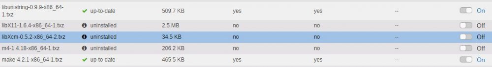

Since the latest unRAID release I do have problems with DevPack modules.
make for instance shows the following error. According to the screenshot attached to this post, make and libunistring are installed and up-to-date. What's wrong with my installation?
Thanks in advance.
root@Tower:~# make
make: error while loading shared libraries: libunistring.so.0: cannot open shared object file: No such file or directory

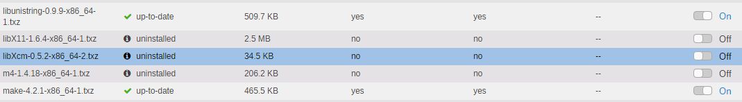

Thanks in advance.
root@Tower:~# makemake: error while loading shared libraries: libunistring.so.0: cannot open shared object file: No such file or directory
I encountered the same thing. The newer package of libunistring doesn't include that link anymore. I'm not sure if other packages need to be updated to not rely on that or what you're compiling relies on it. But you can add the link.
ln -sf /usr/lib64/libunistring.so /usr/lib64/libunistring.so.0
I'll check it out more and possibly just add that command to the libunistring package install
Thanks in advance.
Also what version are you on?
What version? unRAID? 6.5.1.
make throws that error simply when calling it without any parameters. I think make and unistring from the DevPack don't match. make needs something from unistring that unistring no longer supports. I'm a Linux noob but if I should guess I would bet that unistring is from a newer package/release/... than make.
I downloaded and tested newer versions of some packages and the error was gone. Probably just make but I'll update some of the others.  It's just hard sometimes because unRAID is current on some packages but not others.
