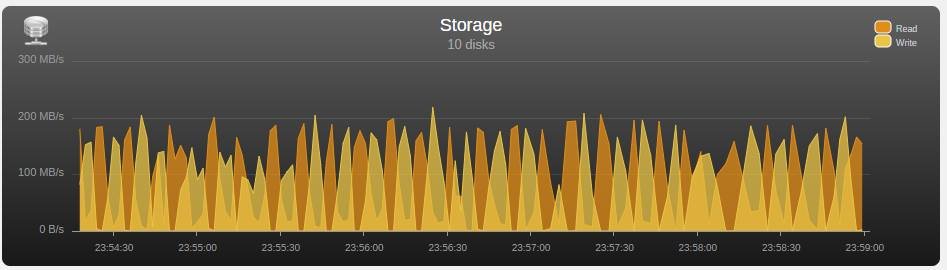

I don't know what to tell you, I have a 90GB file in one share set to cache only, I moved it via the terminal to the storage share (cache-yes) and it took ages. On inspecting the stats graph I got what you see above. If I do moves inside the share then it's instant as it can just update the file table, but across shares, it's doing a physical move. I was told on Facebook that this is the way unRAID works so it can apply disk rules.
I can't even suggest that I might have it configured wrong, as I can't see what you could reconfigure, but it would be damned useful.

I'm going to try moving a large file again in a few hours time, record the steps and see what's going wrong/right.

Ok, so I'm lost now. You are correct, from a user share to another user share the move is instantaneous. Yet I've seen it do it before. My automatic file processors take ages to move a file from my working folder to my storage folder, I have no idea why. I've double checked the container template and the paths are shared by user path.  😕
