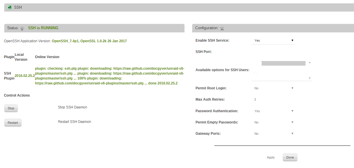

I'd personally disable Telnet via the Common Problems Plugin and enable SSH. I'd also disable Root Login for SSH, Meaning you have to login via a "user" then switch to "su" via console. More or less forces two layers of login vs straight to ROOT.
For the life of me I can't remember how I installed SSH, unless its standard now. Something to research before disabling Telnet thou.

Hmmm, I installed a Plugin called ssh Plugin a while back from docgyver 2016.02.25.2 that no longer appears to be in the App section. It must of not been kept up or something.
I think this should be looked at and made an option for those that don't want to allow root access via the default install or with a small plugin or maybe add to "Tips and Tweaks".
I just put in a request with that plugin and I guess we will see where it goes.
