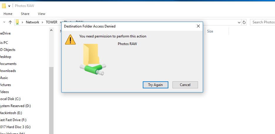

Destination folder access denied
I have set the folder as secure with a password protected user share. But in my tower i can access the public shares but the private and secure shares are showing the denial message i have added here.
I feel the issue is something with the credentials in windows but i dont know to solve them.
Some clear guidance ll help a lot.
The unraid user and password that you used for the secure and private shares need to be set as the same username and password that you log into Windows with. (It also wouldn't hurt to double check that you gave that user read or read/write access to the share in unraid... I ran into that issue recently myself.)
When the unraid box you are accessing from windows has multiple security levels defined, (public, private, and secure) you need to make sure the very FIRST share you access is the highest level you need. If you access a public share first, then windows will provide default windows login credentials and is obviously granted access without prompting. Then when you try to access a more secure share, even though windows pops up a dialog asking for user and password, IT WILL NOT WORK.
Windows will not allow multiple connections to the same server with different credentials. You must disconnect ALL sessions so that a fresh connection with the proper credentials can be made. If you have a mapped drive or some persistent connection to a public share that automatically connects on reboot, you can be beating your head against windows forever and not make a connection.

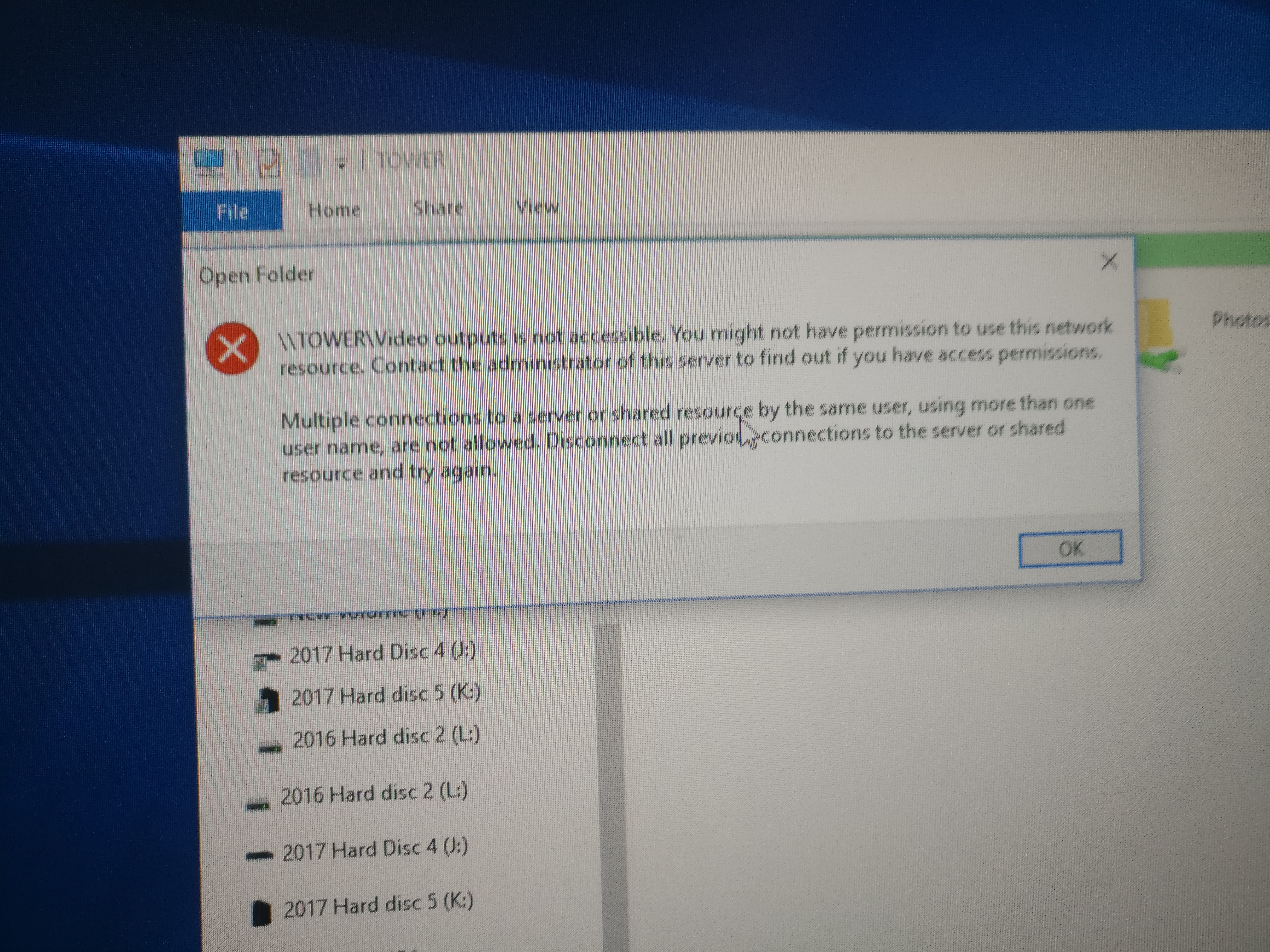

Got this now. When i tried opening a folder which i changed from secure to private.
Credentials seem to be the issue here but am not able to clear them.
Actually i don't know to clear them. I do went to the credentials manager but i could see only the windows system connected in the network not the UNRAID in specific.

Having said this, there appears to be another set of issues that some folks have encountered with the most recent builds of Win10.  But these generally had (in common) the issue of not be able to connect even to the public shares on the server.  One more thing, I believe the only way to disconnect from a SMB session is to reboot (or restart) the Windows computer.
EDIT:   Found this from LimeTech:
To get above to work, you would close any windows that might have a previous connection to the first public share, then open a command window and type "net use * /delete".  That command closes all current server connections.  Now click on your Private share and enter "curly" user name it will work this time.

If the unRAID user doesn't match the Windows user it will prompt you when it first accesses the server, then Windows will remember the login you used for the server.  Where people often get hung up is due to Windows not letting you use a different user after it already has a login for the server. If you need to access the server as a different user, you can fool Windows by using the IP instead of the servername. Or you can go to Control Panel - Credential Manager and clear any unRAID credentials so it will renegotiate.
