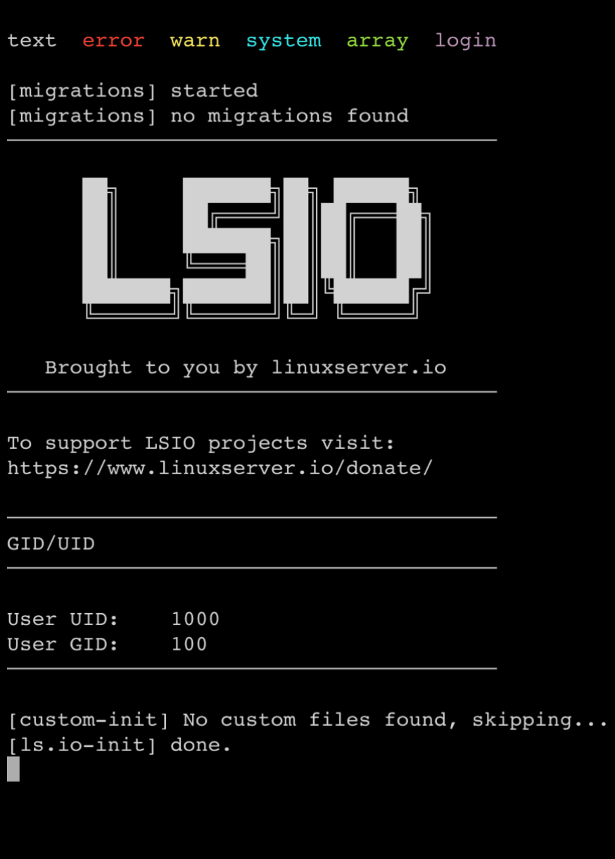

Hello all, I got an odd problem. My webgrabplus doenst start.
what I have done.
- Is changing the MAC adress to the adress where unraid is running on.
- removing the mac adress parameter
everything starts up but nothing is happing not even a log file. This is my log screen.
hope you guys can help. Thanks in advance!

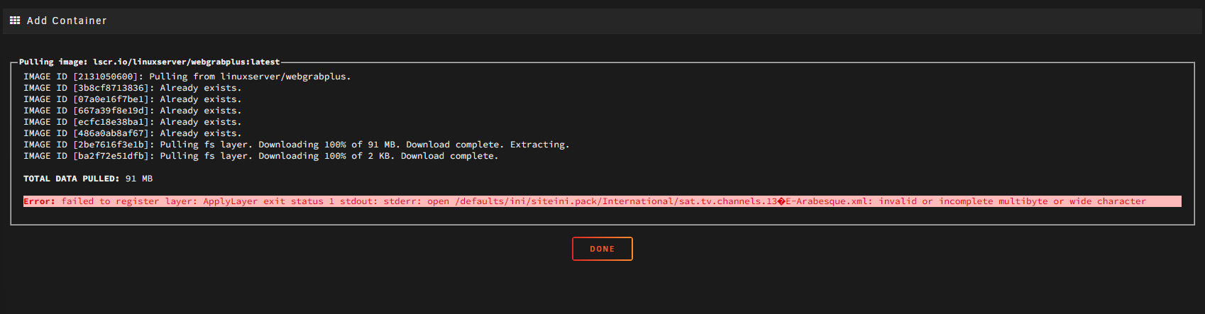

Hi!
I'm trying to get the container up and running but do have an error I don't know how to get it fixed...
This is the error-message while pulling the container:
"Error: failed to register layer: open /defaults/ini/siteini.pack/International/sat.tv.channels.13�E-Arabesque.xml: invalid or incomplete multibyte or wide character"
I do use the default-parameters (unraid-gui) with the following changes:
- set the proper network
- add the /data and /config folders.
As the error is within the container ("/defaults/ini/siteini.pack/International/") I don't think this is something I can fix. As the container isn't starting I do not get any log.
Any hint to get this fixed?
I do have posted an issue at github but hope to have a faster response with the unraid-users.
Thank you!

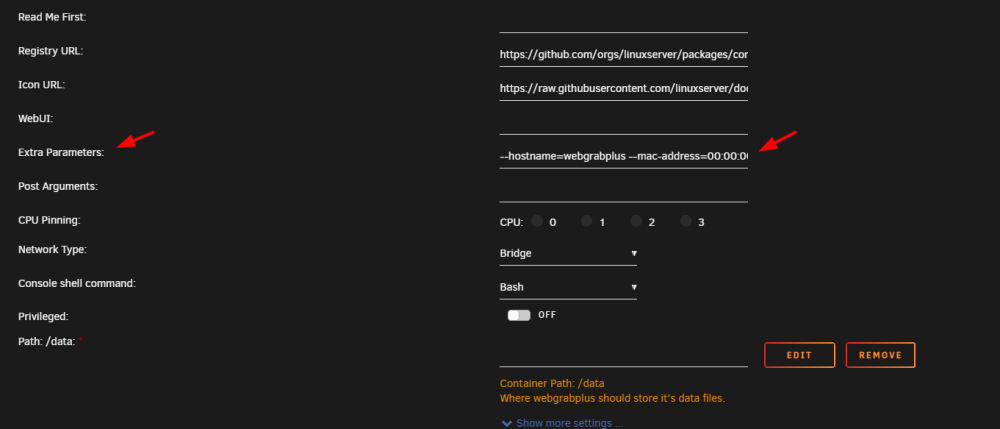

For anyone having issues after an initial install, I'd suggest searching the "container-support" channel in linuxserver's Discord. (The Discord invite link is on the Github page.)
There, I saw suggestions that got the container to work for me. For example, someone said to set the MAC address in the container config to your machine's MAC (which on Unraid can be found in Settings -> Network Settings) or to use a randomly generated MAC. I also fonud the command for running the EPG grabbing manually: "docker exec -it webgrabplus bash", and then "run /app/update.sh". Assuming you have added your webgrabplus.com login details correctly into your WebGrab++.config.xml file, the command should work. For other info on setting up my config file, I referenced https://webgrabplusguide.github.io/.

I am having an issue just getting this to install.
See my logged issue on github here.
It seems as though with my setup at least, that the docker (overlay2 + ZFS, UTF-8-strict) just throws up its hands at the character set in
That "�" is the degree (angle/temperature) sign.
Any way to find a workaround to this so I can install the docker?
