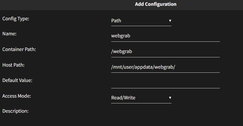

3 hours ago, utentep2p said:
personalize with TZ, '/data' PATH, I write directly into xteve data directory in this example, and RUN, that's all!
you also just could map a path from the xteve container to the webgrab+ data path instead instead ... thats nothing worth to make a seperate publish to CA i would assume ... think about it if all would publish their personal preferences in CA ... which one to choose would be ...
sample
like this you reach the webgrab output inside xteve as path /webgrab/....

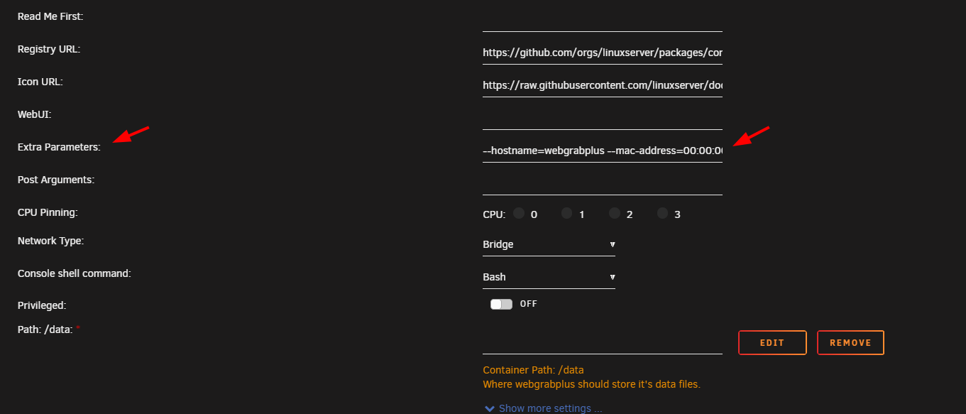

I try to install the Webgrabplus docker, but it fails on install.
Does anyone know what I do wrong?
EDIT:
If i delete "Extra Parameters" option "--mac-address=00:00:00:00:00:00" it will install, but then NO network is available.
Any ideas on how I can fix this, or any parameters I need set?

For anyone (like me) who was still trying to install this:
Its very easy to fix the command failed error just edit "--mac-address=00:00:00:00:00:00" field with your mac address that you find in your network settings. Then it will install and start, but i still didnt got it to work. Shame the support is in Discord as i dislike chats.

2 hours ago, MountainValley said:
Error installing webgrabplus on unraid
error setting interface "vethcdf7e2f" MAC to "00:00:00:00:00:00": cannot assign requested address": unknown.
now ... when you look into your command
--mac-address=00:00:00:00:00:00 'lscr.io/linuxserver/webgrabplus'
why did you add this and as you see, there is your error ...

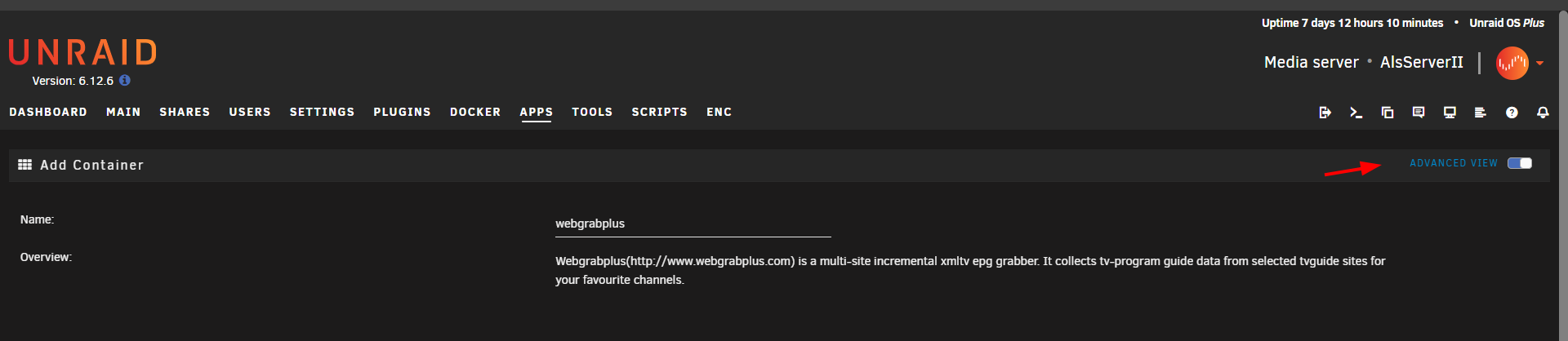

When i click to install app webgrapplus, then this will be the output. There is no possibility to add a mac-address in the installation window.
... just remove it and test again ...
