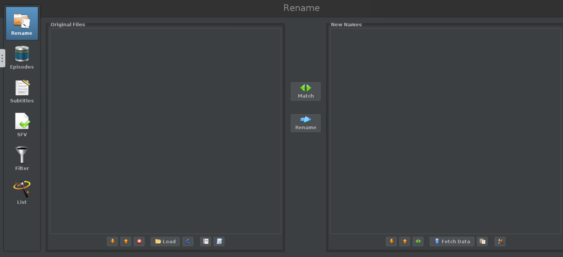

On 7/16/2026 at 11:40 AM, dragoontwo said:
the file or folder selection window now sits in the upper left corner and does not remember resizing
Sorry, not sure I understand what you mean. Maybe share a screenshot of the issue ?
Here you go. I can resize the window, select something, pick to load from folder or file again and get this size window again. It will also originate in the top left corner.
Edited by dragoontwo
I was able to fix the resizing issue by changing the permissions on xdg/config/glib-2.0/settings/keyfile to -rw------- from ----------.
The issue of originating in the top left still persists, but not nearly as annoying as constantly having to resize the window.
Current errors in the log.
[xvnc ] Failed to initialize DRI3 extension
[xvnc ] [mi] mieq: warning: overriding existing handler 0 with 0x1529f1454249 for event 2
[xvnc ] [mi] mieq: warning: overriding existing handler 0 with 0x1529f1454249 for event 3
[app ] Gtk-Message: 09:39:21.195: GtkDialog mapped without a transient parent. This is discouraged.
