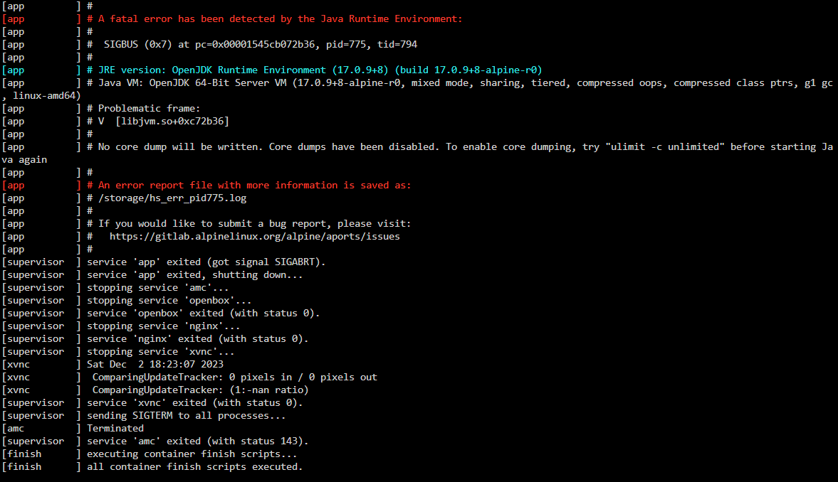

Hey there,
my filebot docker stops with the following error:
Did anybody else got this error before?
Thanks in advance!
EDIT: This issue currently does not occure anymore, it seems like it fixed itself :D
Edited by pappaq
7 hours ago, Djoss said:
How do you reproduce this ?
I just restart the docker. After about a timespan of 8-24 hours it shuts down with this exact error again.
So Filebot is idle and doing nothing ?
Yes. The last message before the error is "nothing to do here" from another amc mover job from hours before.
Edited by pappaq

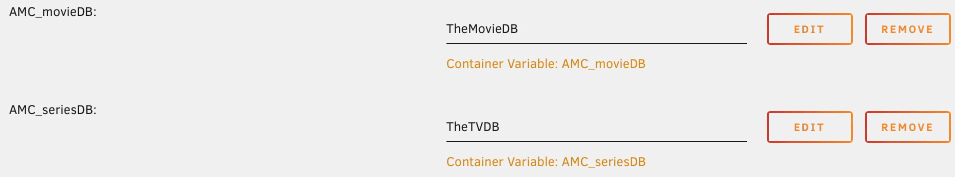

1 hour ago, Teffi71 said:
I run FileBot v5.1.2 with Docker Image v23.11.2 successfully on UnRaid 6.12.4.
FileBot watch folder function works well, too.
Now, I want to specific that FileBot uses TheTVDB as database for TV Shows.
I tired to specify it in the docker template, but that seems not to be working correctly.
Any advice on how to do it correctly?
TIA

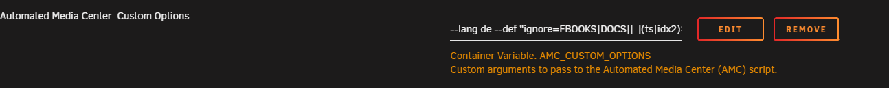

There is no variable that control that.  However, you can add the following to the "Automated Media Center: Custom Options" setting:
--def movieDB=TheMovieDB --def seriesDB=TheTVDB
Thank you @Djoss!
I added that variable.
Now I have to test it ;)
Well - it did not work ...
I added the variable
1812982955_Screenshot2023-12-10at09_40_17.thumb.png.0f8d1509729368834ea7f509af7fd06b.png

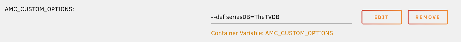

4 hours ago, Teffi71 said:
Any other idea?
may ask in the official filebot forum
sample
https://www.filebot.net/forums/viewtopic.php?t=11518
or also the maintainer is pretty active in discord too ...
i can say the custom AMC function is working here (actually i never tested TVDB format as no need to here)
with some functions added ;)
sample
I will give it another try with the AMC Options variable ...

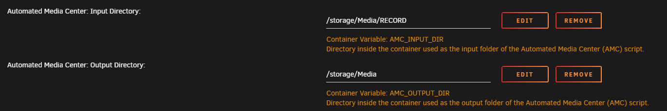

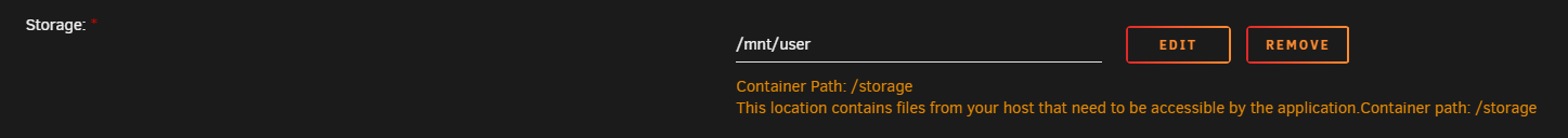

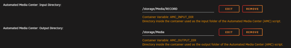

40 minutes ago, Shweeps said:
I suppose there's no solution to fix that? Thanks for your response.
yes there is, use subfolders after ... also described some times already in this thread
sample from here how its moved "instant" as supposed to, from .../RECORD to the proper subfolder in ../Media

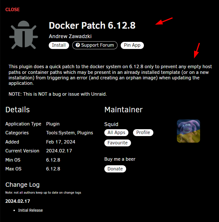

Good evening. I used to have Filebot docker installed on my Unraid, and recently noticed that it wasn't listed. When I tried to do a reinstall it would quickly run and close out but not show up. I attempted to delete the template and even the appdata config file however during a fresh install it fails to install, with the following error:
  -v '':'/watch':'rw'
  -v '':'/output':'rw'
  -v '/mnt/user/appdata/FileBot':'/config':'rw' 'jlesage/filebot'
docker: invalid spec: :/watch:rw: empty section between colons.
See 'docker run --help'.
Any idea what is going on and what I need to do to fix this?
Thanks!
as you see you have no proper configuration.
"before" ... docker engine on Unraid ignored "empty" mount point entries, not anymore
1/ as you dont used them anyway, remove the empty /watch & /output mount entries
2/ or set them up properly by pointig them to a proper location in terms you may want to use this sometime
3/ install the "patch" to bypass the wrong configuration
