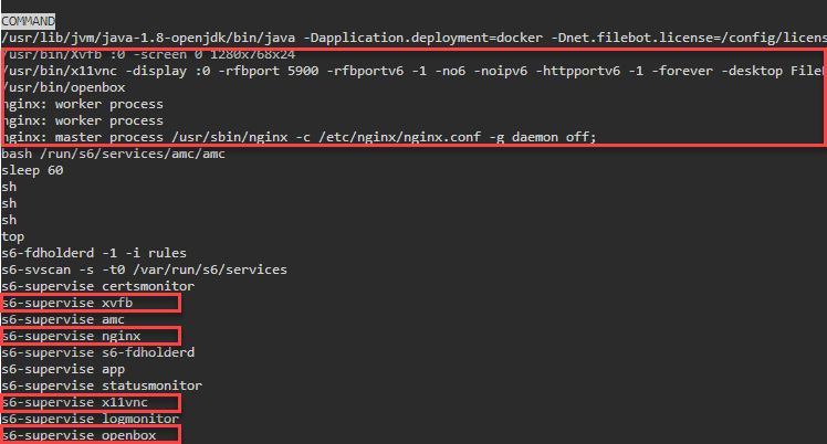

One more thing. As Filebot docker in idle is using 200MB of memory could you add another variable so you have an option to choose if you would like to use web gui or not.
This would then disable execution of those marked processes.

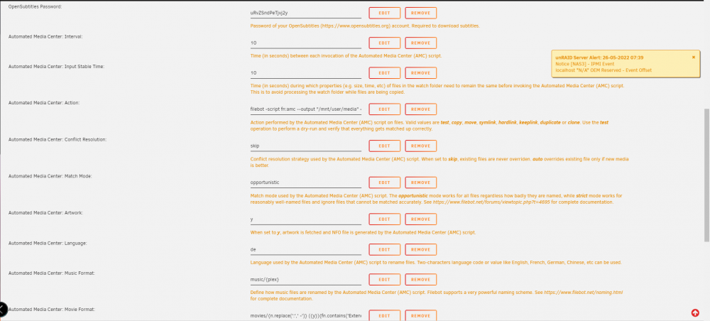

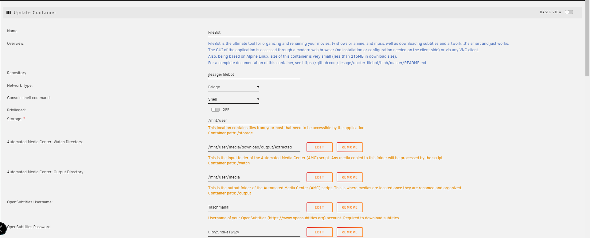

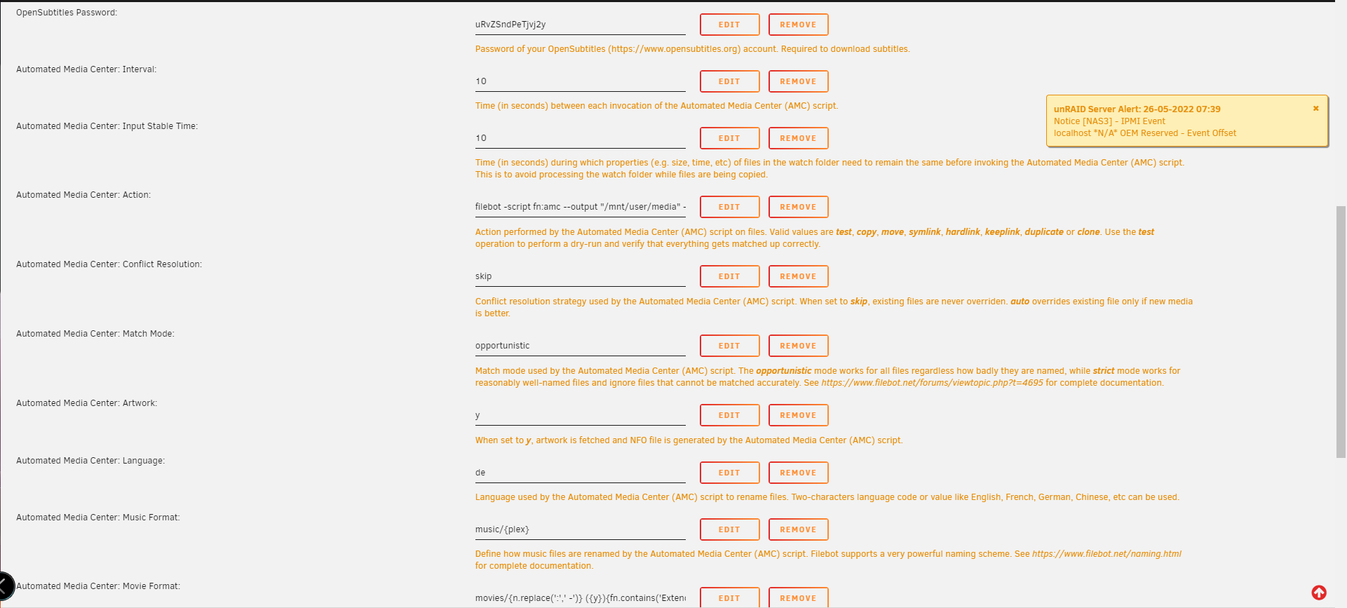

Hey guys and sry in advance,
i used filebot in the gui on a windows machine quiet alot over the years.
Now i've setup an unraid server and installed the filebot docker to use the amc script, it's like i'm not able to get it done anything. How do i have to set it up in the docker?
storage: /mnt/user
watch: /mnt/user/media/download/output/extracted
*note - JDownloader extracts to /extracted - so in there are subfolders by packagename which include the video-files
output: /mnt/user/media
action: filebot -script fn:amc --output "/mnt/user/media" --action duplicate -non-strict "/mnt/user/media/download/output/extracted" --log-file amc.log --def excludeList=amc.txt
music format: music/{plex}
movie format:
movies/{n.replace(':',' -')} ({y}){fn.contains('Extended') || fn.contains('EXTENDED') || fn.contains('extended.cut') ? ' (Extended)' : fn.contains('Theatrical') || fn.contains('THEATRICAL') || fn.contains('theatrical.cut') ? ' [Theatrical]' : fn.contains('Special Edition') || fn.contains('SPECIAL EDITION') || fn.contains('SPECIAL.EDITION') ? ' (Special Edition)' : fn.contains('Unrated') || fn.contains('UNRATED') ? ' (Unrated)' : fn.contains('Uncensored') || fn.contains('UNCENSORED') ? ' (Uncensored)' : fn.contains('Remastered') || fn.contains('REMASTERED') ? ' (Remastered)': fn.contains('Limited') || fn.contains('LIMITED') || fn.contains('Limited Edition') || fn.contains('LIMITED EDITION') ? ' (Limited Edition)': fn.contains('Ultimate') || fn.contains('ULTIMATE') || fn.contains('Ultimate Edition') || fn.contains('ULTIMATE EDITION') ? ' (Ultimate Edition)': fn.contains('Director') || fn.contains('Directors') || fn.contains('Directors Cut') || fn.contains('dc') || fn.contains('Director\'s Cut') || fn.contains('DC') ? ' (Directors Cut)':"" }/{n.replace(':',' -')} ({y}){fn.contains('Extended') || fn.contains('EXTENDED') || fn.contains('extended.cut') ? ' [Extended]' : fn.contains('Theatrical') || fn.contains('THEATRICAL') || fn.contains('theatrical.cut') ? ' [Theatrical]' : fn.contains('Special Edition') || fn.contains('SPECIAL EDITION') || fn.contains('SPECIAL.EDITION') ? ' (Special Edition)' : fn.contains('Unrated') || fn.contains('UNRATED') ? ' (Unrated)' : fn.contains('Uncensored') || fn.contains('UNCENSORED') ? ' (Uncensored)' : fn.contains('Remastered') || fn.contains('REMASTERED') ? ' (Remastered)': fn.contains('Limited') || fn.contains('LIMITED') || fn.contains('Limited Edition') || fn.contains('LIMITED EDITION') ? ' (Limited Edition)': fn.contains('Ultimate') || fn.contains('ULTIMATE') || fn.contains('Ultimate Edition') || fn.contains('ULTIMATE EDITION') ? ' (Ultimate Edition)': fn.contains('Director') || fn.contains('Directors') || fn.contains('Directors Cut') || fn.contains('dc') || fn.contains('Director\'s Cut') || fn.contains('DC') ? ' (Directors Cut)':"" } {vf}
tv series format: series/{n.replace(':',' -')}/Season_{s00}/{n.replace(':',' -')} - {s00e00} - {t.replace(':',' -')} - {vf}
anime format: anime/{plex}
the naming schemes worked fine on windows gui filebot.
What am i doing wrong, what needs to change? I've got a tv series file directly in the /extracted and in /extraced/nameoffile/nameoffile.mkv Filebot doesnt copy/rename/relocate anything.

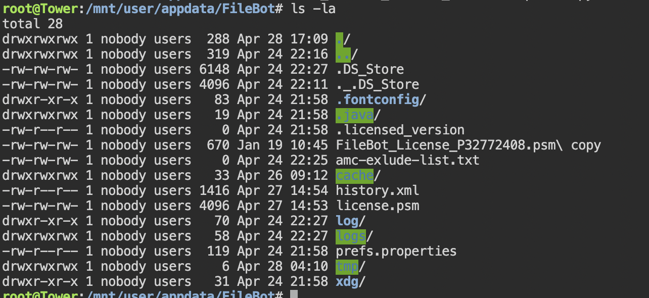

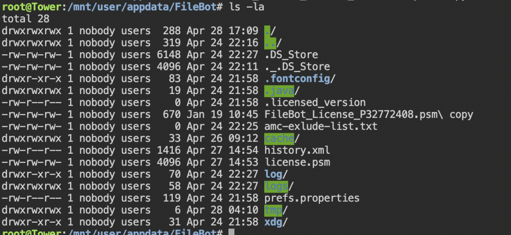

Something very strange started happening with my license file. My license is good until Jan of '23 and I had it working fine since I renewed this past January.
All of a sudden a couple days ago I started getting errors that the license was invalid. I checked and the license file is still there, but it's now a 4kb file (instead of the normal 670 bytes) that I can't open in a text editor. If I replace the file it will work for like a day or less before magically getting converted into the 4kb file again.
As you can see in the attached screenshot, license.psm is 4096 bytes. The FileBot_License.... file is a copy I just started keeping in there so I didn't have to keep re-downloading the license. You can see it's the normal 670 bytes.
1680926632_ScreenShot2022-04-28at5_10_17PM.thumb.png.80b4e902936460d00be472a2f23fd7d9.png
I've tried restarting the docker container, restarting the UNRAID server and doing a parity check, and deleted and reinstalled the docker container to no avail. Anybody have any idea what might be causing my license file to become corrupted? Thanks!
actually not, anything in your filebot logs ?
otherwise i rather would check my disk(s), depending now where your appdata is located ...
sample from here
root@AlsServer:~# ls -la /mnt/cache/appdata/FileBot/ | grep -i licens
-rwxrwxrwx  1 nobody users      0 Jul 15  2020 .licensed_version*
-rwxrwxrwx  1 nobody users    661 Dec  5  2020 FileBot_License_P21124142.psm-BACKUP2021*
-rw-rw-rw-  1 nobody users    661 Dec 12 11:31 license.psm
-rwxrwxrwx  1 nobody users    673 Jul 15  2020 license.psm-BACKUP2020*
-rwxrwxrwx  1 nobody users    661 Dec  5  2020 license.psm-BACKUP2021*
root@AlsServer:~#

How are you using this ?  Are you invoking the filebot binary yourself or you are using the integrated AMC feature of the container ?
Hello, sry for the late answer, i was in recovery from a health issue.
I am using it in die Docker configuration:
notice: I've already changed the pw form the first screenshot
Edited by Taschmahal

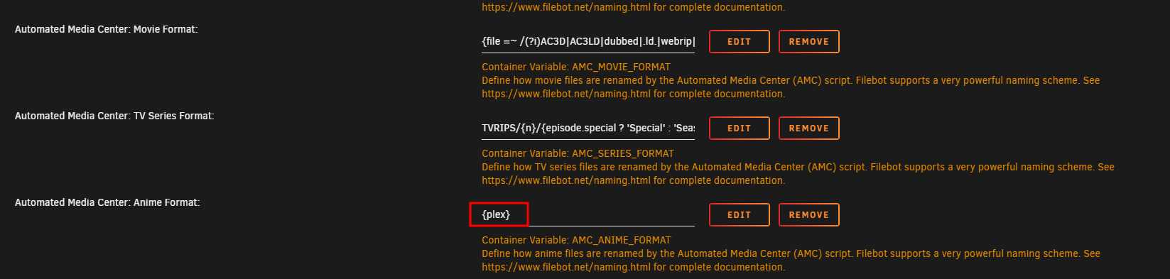

Note that you should not put cli parameters directly in configuration.  For example, look at the description of "Action": you should only use one of the allowed values.
Also, for movies/series formats: you might need to do some escaping.  For example, you could try to change "" by ''.
You can also try to temporarily set formats to {plex} to see if at least AMC is working.

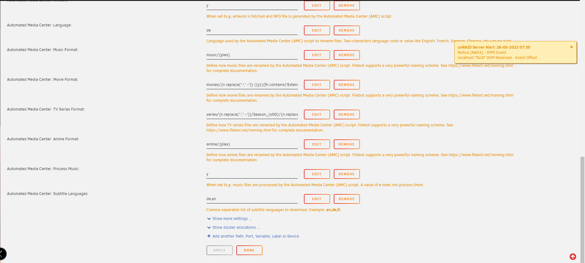

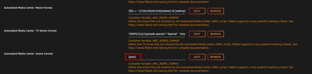

So i tried to remove all parameters from Action and changed it to "move". And also changed my series formats (my testfile) to "series/{plex}" - nothing happens. I have also tried if i am missing / by the folder structures.
Is there any setup with screenshots and explanations for a unraid doccker configuration, or how else can i setup the AMC and what do i have to do then with the docker setup (default settings?).
Thanks for the support.
you may should test {plex} only to start with, like this in your Movie and TV section ...
i have some custom formats as im splitting into 2 different Movie Main Dirs ... so hard to use as sample.
But {plex} is the way to start with, it will also use the top level folders (Movie, Series) already ...
may as startpoint (and filebot btw has nice documentation, active forum and active discord channel from the developer)
https://www.filebot.net/naming.html
