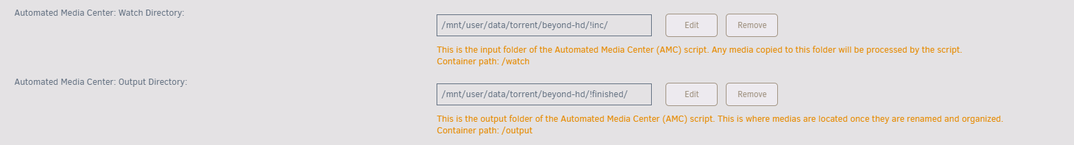

I would love it if someone would explain this a little more. I have tried for two night to make it work and I dont understand what is meant by that post.
may post your layout how you want to move, from -> to ...
in the end its simple, from docker point of view we need to stay on the same "mountpoint" to really move, so i suggested to use /storage (docker point of view) as /mnt/user
then u have a input/output which bot start with /storage/.... so we are for the docker point of view in the same mountpoint.
leave a note where you struggle and pretty sure someone will give you a suggestion, also to check yourself there where some hints from @Djoss which poinzed me in the right direction.

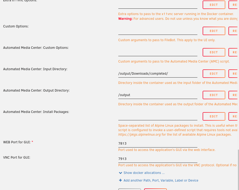

Do I delete the first two mount points /watch /output and only use the ones in advanced?
EDIT: image.thumb.png.58f91857d96ea0b94714e1088b63ed43.png
Edited by Plimmer
No need to remove them.  You can just clear the value of you don't need them,

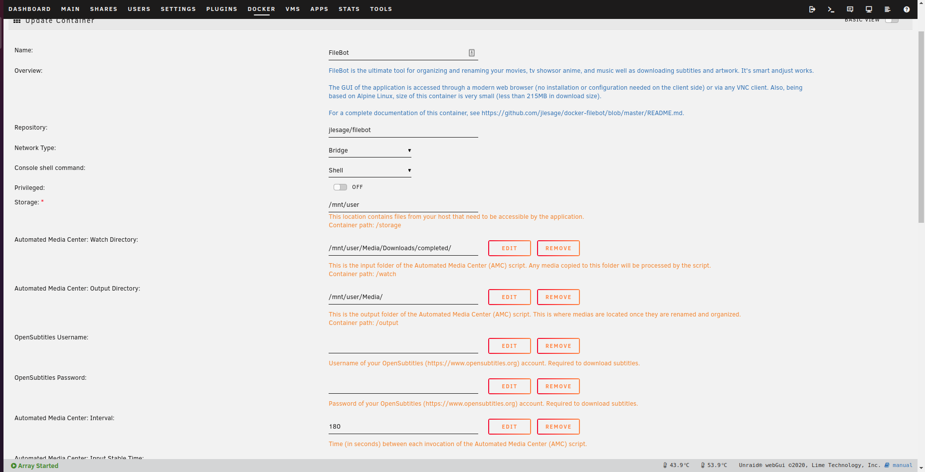

I'm having trouble hardlinking files using the AMC script. I am able to hardlink manually in the WebUI so I think it has to do with my volume mappings? Here's the error:
And here are my mappings:
Movie output naming:
Thanks in advance for your help!
15 hours ago, saddl said:
Hi all,
It may be related to the fact that you hard linking between different volumes.  When you use the UI, are you doing the same thing ?
