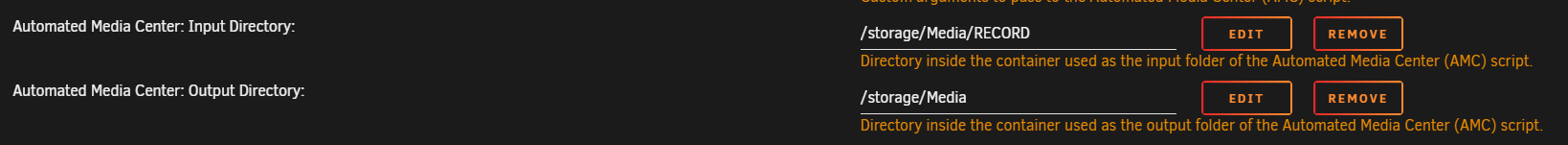

as i also struggled with the variables ... here a working solution to really move
this will move from /Media/RECORD to /MEDIA/HDDVDR/.. /MEDIA/TVRIPS/... when your MOVIE, TV, ... amc ... starts with TVRIPS/... HDDVDR/...
That makes perfect sense. I didn't realize those variables could be used to replace the /watch and /output mappings
