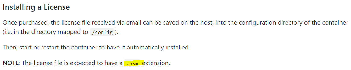

Hi guys,
I'm sorry if this is a stupid question. I'm completely new to Unraid and filebot.
I downloaded filebot yesterday on my Unraid setup. but it won't rename my video files. I figured out where the logs are. and it says
"FileBot requires a valid license. Please run `sudo -H -u app filebot --license *.psm` to install your FileBot license.
Bad License (>_<)"
I then bought a license for 1 year to test with. but I can't seem to figure out where to activate it, even through the console of the container.
Can anyone help me with what I'm doing wrong?
here it worked like described on the github page.
