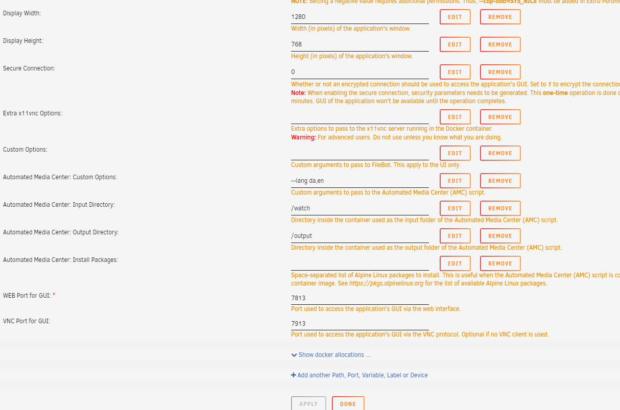

@Smorand this is more a Filebot related question and not about this docker, may start reading about the amc options and/or ask in filebot forums or discord channel, author of filebot is also very helpful as note.
may as hint, did u try the option --lang fr in your custom options as sample ? here a sample in german "de"

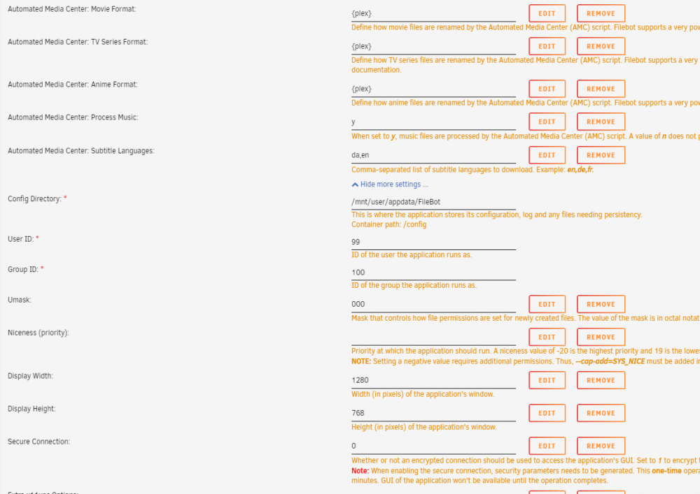

may as hints how mine is setted up
movie/tv format
Subs
extra script
as u see i need bash so i install this as extra option in the buttom too etc etc .. so basically, just fit your commands to the given parameters which are all there as u posted them.

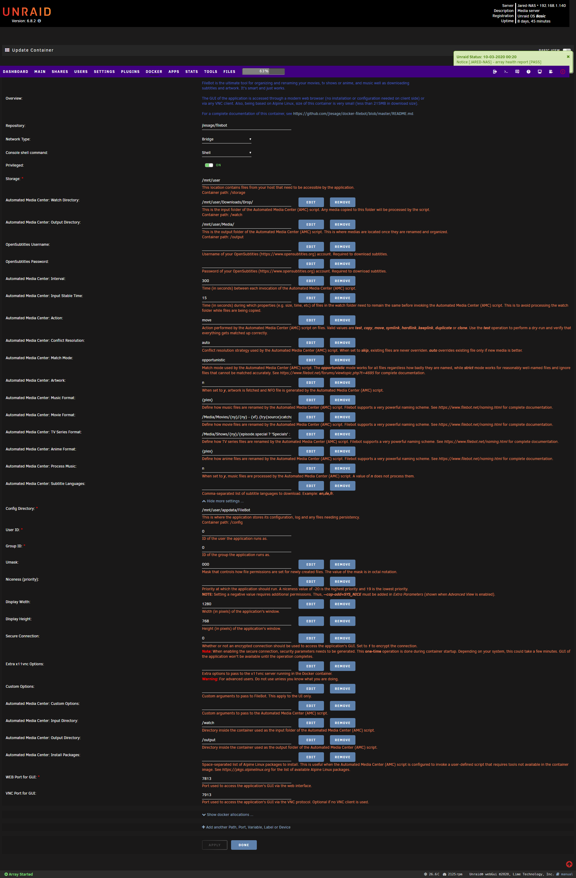

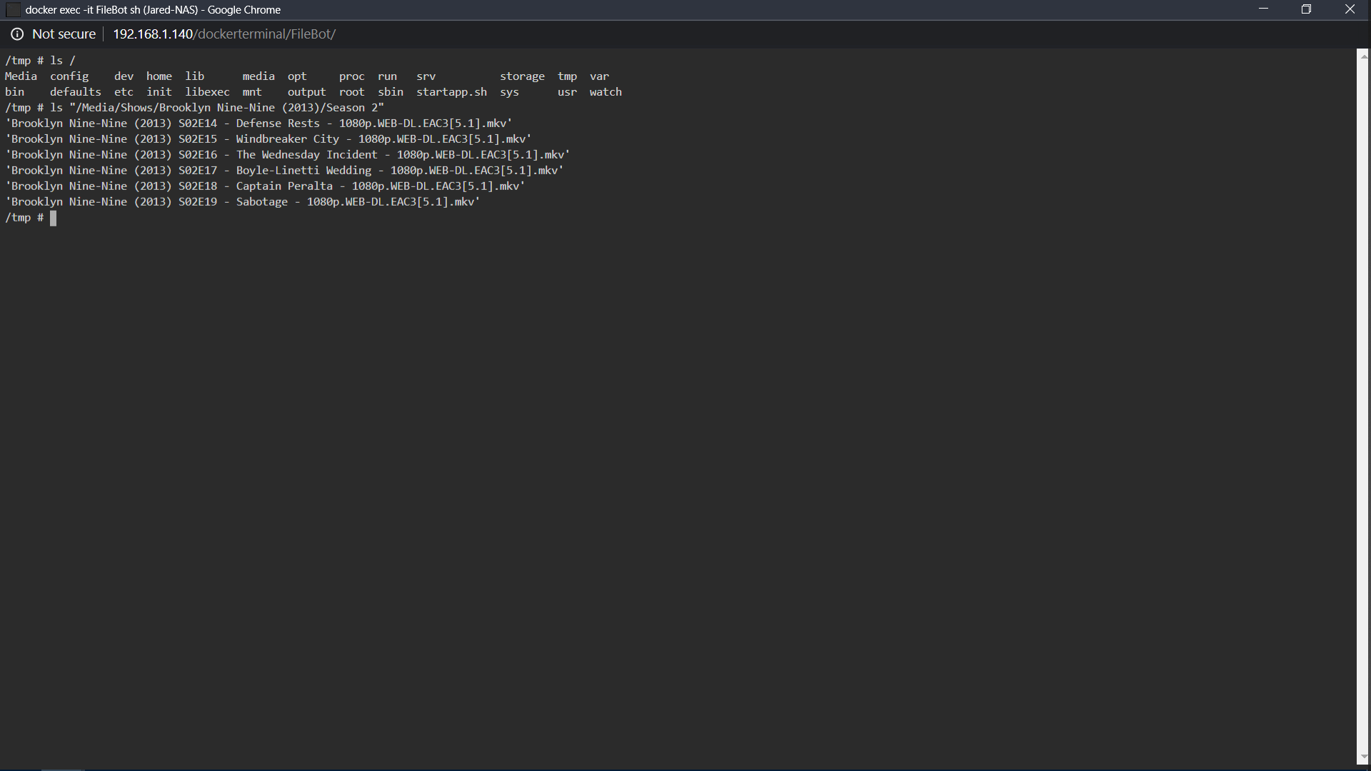

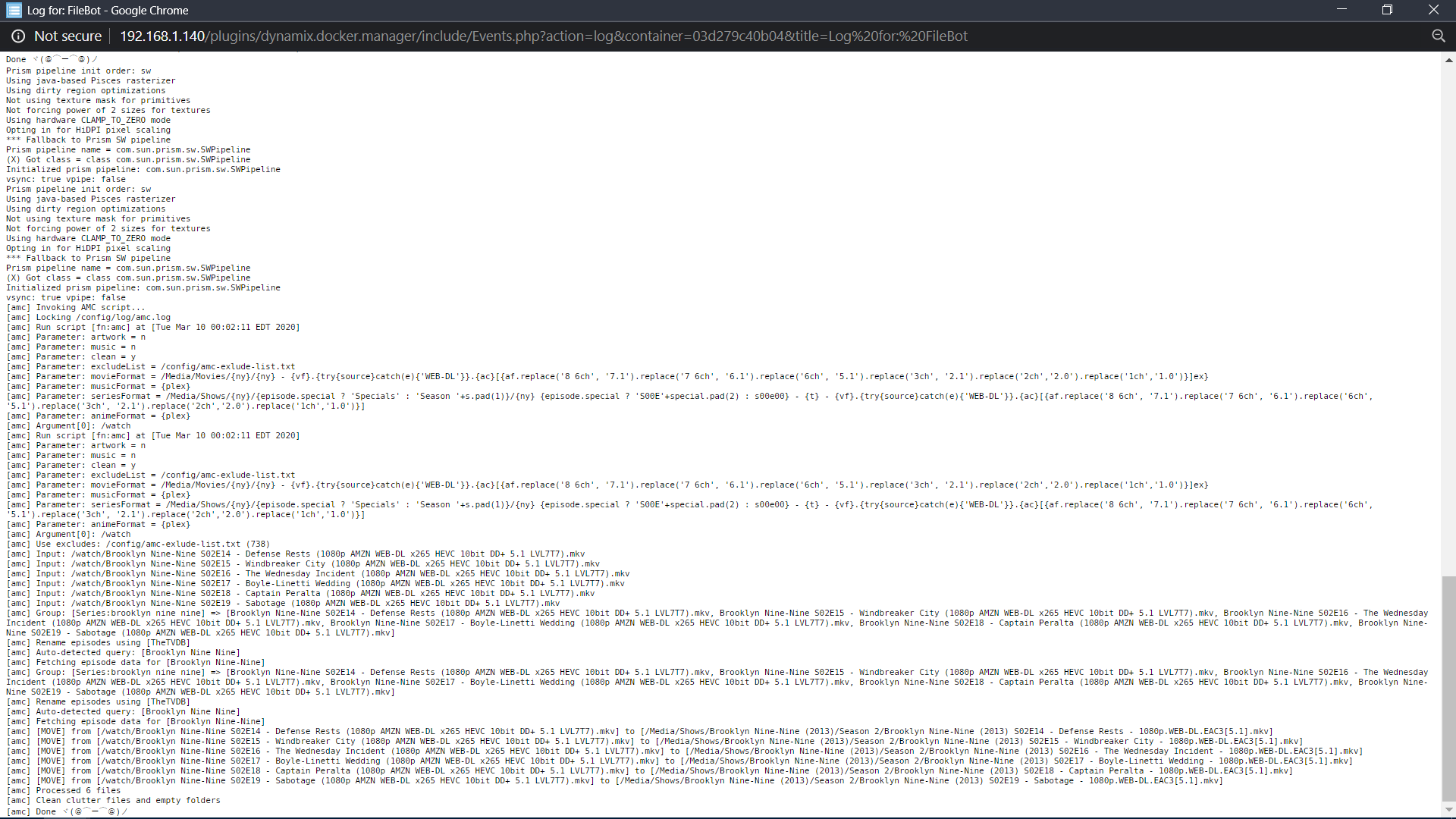

Im having a big problem with my Filebot docker.  Rather than moving from the watch folder to my media folder OUTSIDE of the container,  FIlebot is moving the files from /watch >> /Media inside the container and filling my docker.img. Can someone please help me out?
Attached are my template, log file, and screenshot of container file structure
You should not set absolute paths in your Format settings.   Try removing them.

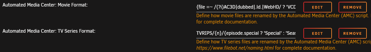

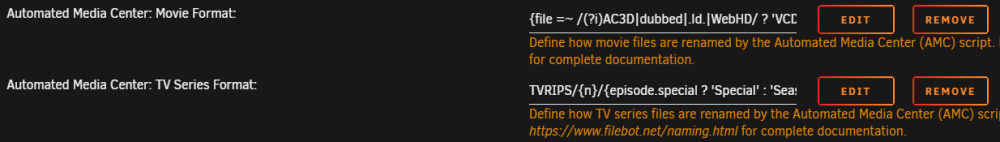

or as mentioned take a look at the readme of filebot ... there are ways to seperate them, sample here from my MOVIE FORMAT
{file =~ /(?i)AC3D|dubbed|.ld.|WebHD/ ? 'VCD' : 'HDDVDR'}/{n} ({y})/{n} ({y}) - {vf}{' CD'+pi}{'.'+lang}"
this will either output to /VCD or /HDDVDR depending on the naming schema from input ...
if the input contains as sample "WebHD" it will move the renamed file to /VCD/.... if not it will move to /HDDVDR ...
so if your kids movies are tagged somehow u could split it easy ... really consider to follow filebot help channel(s) ...
