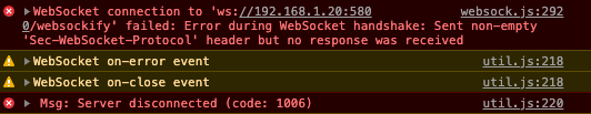

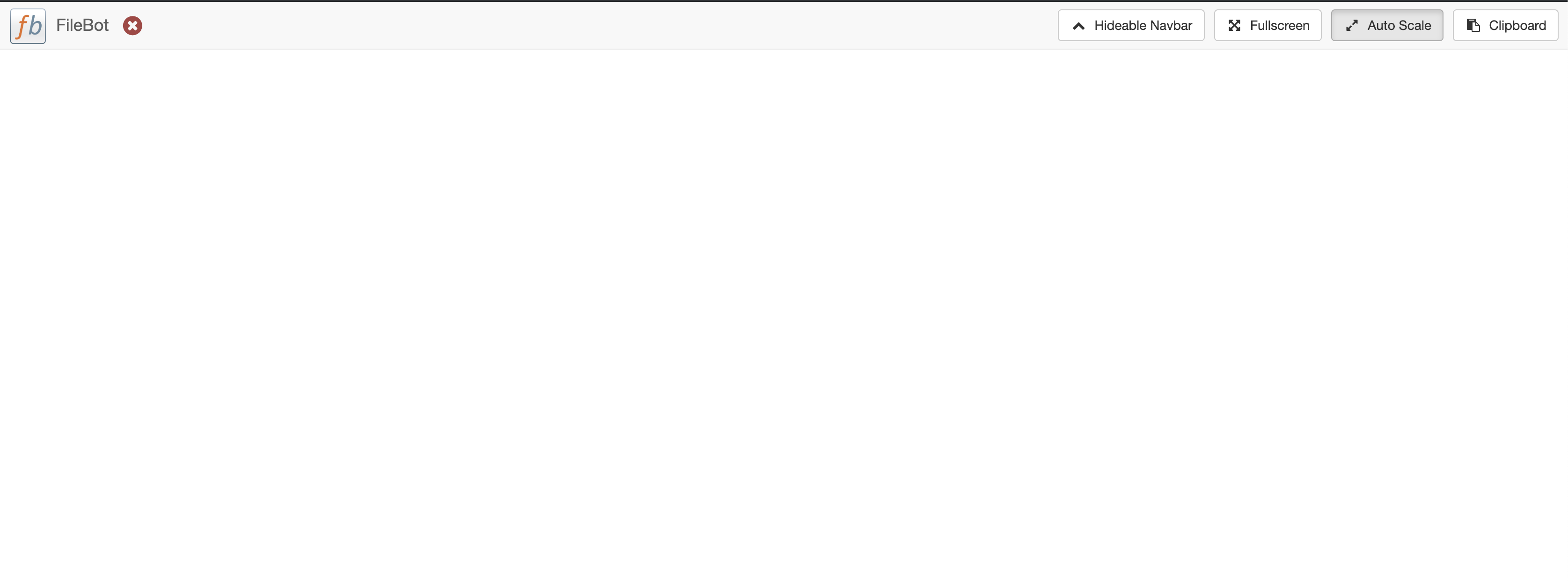

Hey Everyone!
Sorry if i ask any dumb questions
I recently got down to trying to sort out my library and trying to name it. Just came across Filebot and it seems very promising!
I was able to the AMC portion to work once i bought a license but i cant seen to get the webgui to work.
It just shows an empty screen and n
it says server disconnected (Code: 1006) at the X
I am not sure what other information to provide to give you an idea of what i can change
Thanks in advance!

Try to clear your browser's cache to see if this helps.
Thanks! that seems to have done the trick!
Not sure why i didnt think of that.
