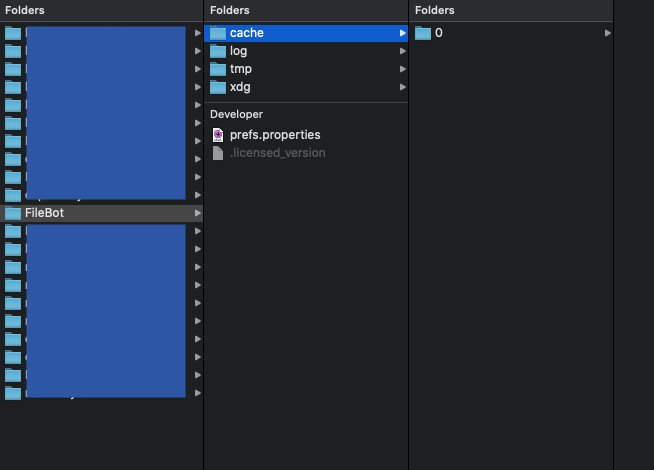

*****OLD POST
Hello,
I cannot find filebot.conf file in order to activate webGUI to yes
I was running filebot by jlesage on UNRAID v6.7.x without issues. Then I updated Filebot, then updated UNRAID OS to 6.8, and was using filebot for few days. Then filebot wouldn't restart one day. Then I tried updating filebot, didn't work. Then I deleted filebot, and folder under appdata/filebot, then reinstalled filebot.
I cannot run filebot in Web UI, because I cannot find filebot.conf file anywhere in appdata folder on UNRAID, in order to set WebUI to "yes".
Where do I find filebot.conf, to set web UI to "yes"?
Alternatively, what am I doing wrong so much that I cannot access WebUI on default port 7813?
Below is image from folder "appdata"
Thanks.
