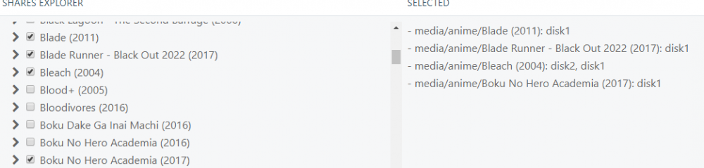

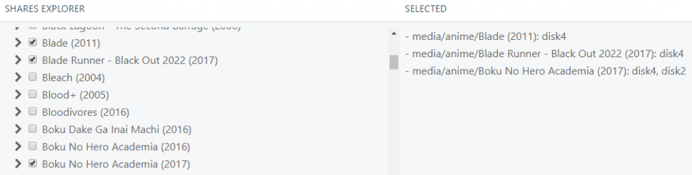

  11. I'm moving around Movies, Anime and TVShows. I started with Anime. As for special characters...most don't have anything outside the norm. They typically will have a period, comma, dash, squared brackets and/or exclamation points. See the screen shots Sample folder listing Sample File Name List: As for the size....I've tried multiple tests. The error happens with selecting 1 folder, Bleach for example, or selecting many of folders. Selection total > 20GB fails Selection total < 20GB transfers no problem Folder Selection < 20GB Completed: So now i'll select the same 3 series + add Bleach. This batch will be > 20GB. Click Proceed and goes right to here: Log only shows this one error: W: 2017/12/17 08:38:20 server.go:331: closing socket (&{ws:0xc420116870 onMessage:0x6e6730 onClose:0x6e6780}): unexpected end of JSON input BTW.....Sorry for all the posts!! Looking at the logs saw something else that looked a tad strange....grabbed 7 series that were about 22GB In the logs I see this: I: 2017/12/17 09:44:41 planner.go:490: [143.32 MB] /mnt/disk4/media/anime/Denpa Onna to Seishun Otoko (2011)/./Ground Control To Psychoelectric Girl - Special 02 - The Nightmare Sun [1280x720 x264 AAC 2ch] [F327A5D6].mkv I: 2017/12/17 09:44:41 planner.go:493: --------------------------------------------------------- I: 2017/12/17 09:44:41 planner.go:494: I: 2017/12/17 09:44:41 planner.go:485: ========================================================= I: 2017/12/17 09:44:41 planner.go:486: disk(/mnt/cache):items(77)-(22.27 GB):currentFree(321.28 GB)-plannedFree(299.01 GB) I: 2017/12/17 09:44:41 planner.go:487: --------------------------------------------------------- I: 2017/12/17 09:44:41 planner.go:490: [343.12 MB] /mnt/disk2/media/anime/Chaos;Child (2017)/./Chaos;Child - 07 - Episode 7 [1280x720 x264 AAC 2ch].mkv I: 2017/12/17 09:44:41 planner.go:504: ========================================================= I: 2017/12/17 09:44:41 planner.go:505: Bytes To Transfer: 155.89 GB I: 2017/12/17 09:44:41 planner.go:506: --------------------------------------------------------- W: 2017/12/17 09:44:48 server.go:331: closing socket (&{ws:0xc420116240 onMessage:0x6e6730 onClose:0x6e6780}): unexpected end of JSON input Why does it say Bytes to Transfer is 155GB? when in the previous line is shows 22.27GB? Also what is it doing with the cache disk in that same line?....out of curosity Anything else i can test for ya! Let me know! Urlryn
  12. Attempting to merge a bunch of video files...from /mnt/disk3/media/anime (2TB free on this disk) to /mnt/disk2/media/anime clicking proceed...it flashes to a empty transfer page. Looking at the logs: I: 2017/12/16 19:37:41 planner.go:493: --------------------------------------------------------- I: 2017/12/16 19:37:41 planner.go:494: I: 2017/12/16 19:37:41 planner.go:504: ========================================================= I: 2017/12/16 19:37:41 planner.go:505: Bytes To Transfer: 315.27 GB I: 2017/12/16 19:37:41 planner.go:506: --------------------------------------------------------- W: 2017/12/16 19:37:48 server.go:331: closing socket (&{ws:0xc4201f81b0 onMessage:0x6e6730 onClose:0x6e6780}): unexpected end of JSON input I: 2017/12/16 19:37:48 core.go:158: Sending operation I: 2017/12/16 19:38:17 core.go:148: Sending config I: 2017/12/16 19:38:17 core.go:153: Sending state I: 2017/12/16 19:38:17 core.go:163: Sending storage I: 2017/12/16 19:38:18 core.go:171: Sending history I: 2017/12/16 20:01:14 core.go:148: Sending config Broke out the transfer into smaller groups (half of what was done previous) for test....would still happen. Then did even smaller groups (1/3 the size)...same thing Kept going down till i was doing 3-10 series and they would transfer fine. Seems something is up with total size.....20GB is max I can seem to move. Anything higher will generate the above issue. Issue 2 Gather > Select Folder > Choose Target drive > click Previous It never goes back and loads the screen. The 4 bars on the top right is showing activity but it never does anything. Refreshing the window is the only way to get back. Issue 3 Gather > Select Folder > Choose Target drive > Click on Gather again > Select folders > Click Next Same as above....never finishes loading the screen and the 4 bars show activity...but nothing happens. Urlryn
