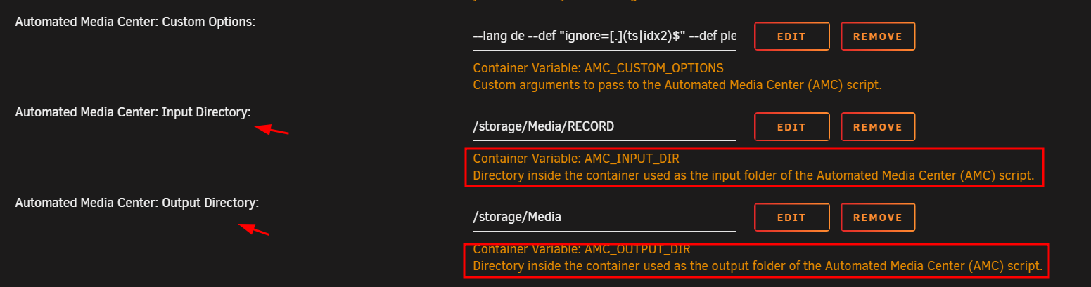

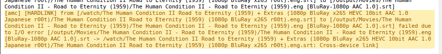

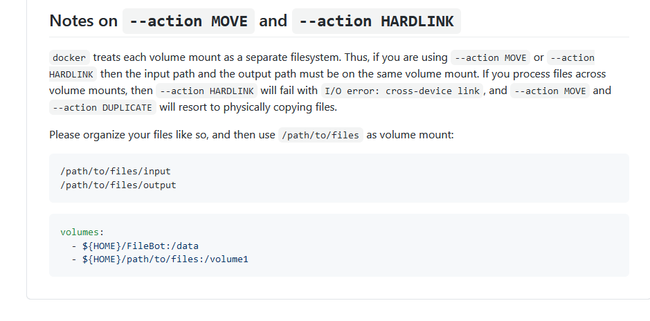

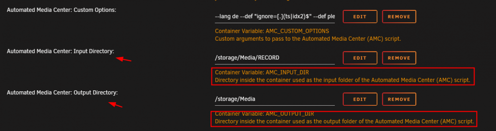

I have a question about hardlinking on the AMC.
Could someone point me to how I need to set up my input and output directories to allow for hardlinking? Currently I'm getting the "I/O cross link" error and it resorts to copying files over.
My initial setup was:
input -> /mnt/user/downloads/completed
output -> /mnt/user/media
But after I found this .... (from https://github.com/filebot/filebot-docker#notes-on---action-move-and---action-hardlink )
I switched to:
input -> /mnt/user/media/downloads/completed
And I still get the same error, which looks like this:
Could someone help me with the proper setup so as to allow AMC to hardlink?
Thank you so much, from an ignorant noob.

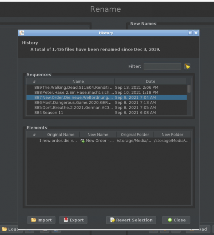

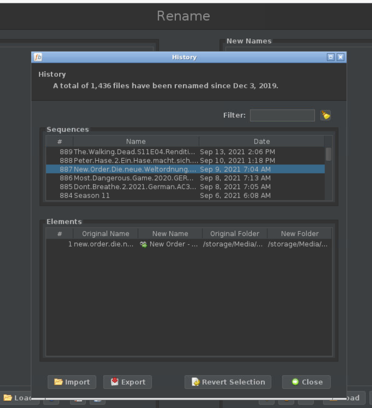

Hello,
My container works fine to rename my files, but I have no history.
is there a way to have it? it's sometimes usefull.
thanks
not there ?

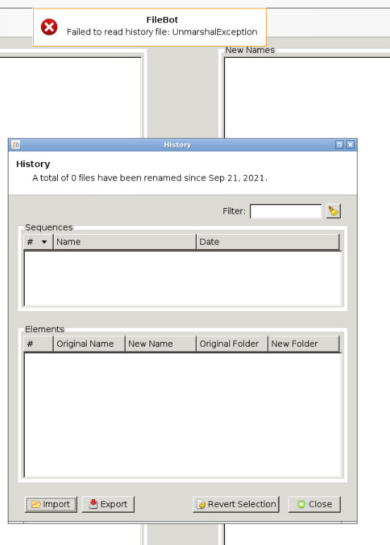

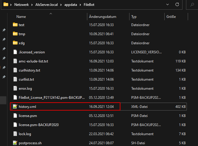

Hello, the file is there and dates from today, but when I try to load it, I get the message.
Looks like the file is corrupted ?  Did you try to see its content with a text editor ?
i can just confirm it should work
so may open the file like suggested to check whats inside
file could open fine in notepad++. I tried deleting it and it created it again. everything is ok. I just don't have old history but it should be ok
thanks

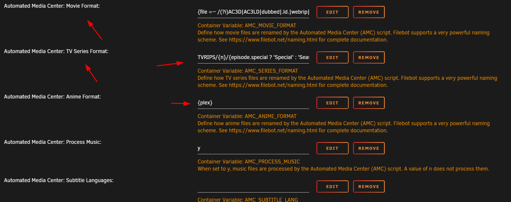

Hi there, is there a guide or has someone asked about setting up filebot with jdownloader? I want to use the AMC Scripting stuff, but I have no clue what parts to edit. Is it possible to set filebot to monitor 2 folders. 1 being films, and the other being tv shows. then filebot can rename and move films and tv shows. any way to do this? please
filebot recognize what a film and a tvshow is ... and move them accordingly, no need to monitor 2 different instances, just where your final unpacked jdownloads are ...
filebot has a great tutorial, forum and a good discord (dev is pretty active there), so you should find what you looking for.
Tipp, there is a reason why there are these config options ... read the filebot manuals and you should know what is todo or keep it simple as {plex}
AHA! so for the monitoring, I would just paste in the watch folder and then have how its set (so stick with plex options). but how do i them run the amc? do i need to just add after {plex} where to send files to? such as /mnt/user/Hoard/video/tv-anime/{plex} in the fields there?
please read the infos on the variables, try it and see what happenssc...
tap the show more settings button as sample.

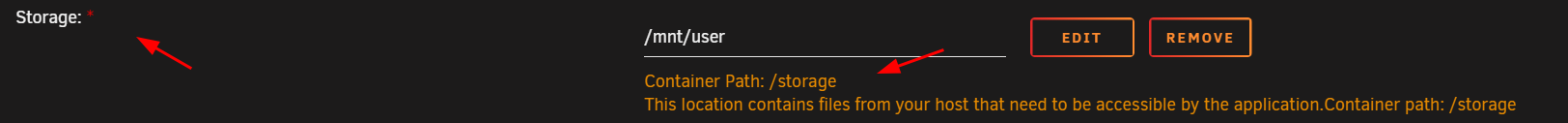

while /storage was configured at the beginning
Ok thank you @alturismo. Think I have it all setup and working. guess now I just need to get a licence then check logs that the test option will work. then change the test variable to move. Then Im sorted.

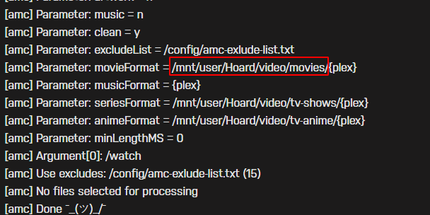

Ok so I have got everything setup with test. I did get i/o error read write in the logs. I did see a solution was to add --def minLengthMS=0 into the advanced parameters. but it seams that file-bot isnt moving tv shows even though they are there and is set correctly. I just get
[amc] Invoking AMC script...
[amc] Run script [fn:amc] at [Mon Oct 11 11:39:15 BST 2021]
[amc] Parameter: artwork = n
[amc] Parameter: music = n
[amc] Parameter: clean = y
[amc] Parameter: excludeList = /config/amc-exlude-list.txt
[amc] Parameter: movieFormat = /mnt/user/Hoard/video/movies/{plex}
[amc] Parameter: musicFormat = {plex}
[amc] Parameter: seriesFormat = /mnt/user/Hoard/video/tv-shows/{plex}
[amc] Parameter: animeFormat = /mnt/user/Hoard/video/tv-anime/{plex}
[amc] Parameter: minLengthMS = 0
[amc] Argument[0]: /watch
[amc] Use excludes: /config/amc-exlude-list.txt (15)
[amc] No files selected for processing
[amc] Done ¯_(ツ)_/¯
But there are files, so move them. I have tried restarting and setting the wait time from 1800 seconds to 60 and that made no difference. @alturismo
however you come to this setup ... you didnt read the docs ... there shouldnt be any root path.
and im not your filebot helpdesk ;), read upper ... start with the readme for this docker, in terms on filebot questions i pointed you where to get the best help.
You can probably keep all the default settings.  Just set the folders on unRAID that will be used for your watch and output folders (Automated Media Center: Watch Directory and Automated Media Center: Output Directory).

Hi guys. I have a dumb little question about my filebot docker.
It works great. Everything like it should, BUT: It always renames my files and folders in english. I want all my files in german. Even when they are german, they get renamed to the english version. On the WebUI i can select german and it works fine. But automated it grabs the files and in the destination folder they are english.
i guess it is just a command line. but did not find anything about it.
Greets and thank you in advance :)
