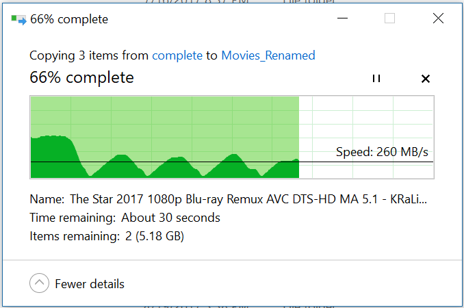

Hello, I am seeing write speed vary when moving large files. Any ideas why I am seeing this behavior? It happens both to cache and array writes.

So bottom line this is moving data from one share on the cache pool to another one. I would expect a fast transfer. Looks to me it first copies to ram. Once the ram is exhausted then it flushes to disk. Maybe that is what is causing the sawtooth. I would like to figure it out and try to fix as the transfer rate goes to zero sometimes and just seems to hang there a bit. Then things take back off again. Think it is a config issue but not sure.

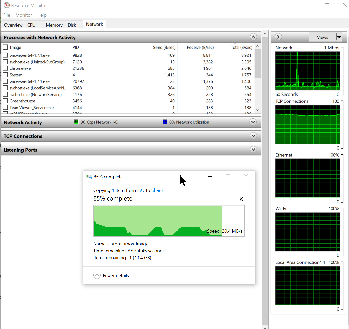

Side note if I move a large file to the array I see the same sawtooth behavior, just at a much slower throughput.
PWM: The data isn't moving to the windows machine. I have verified this by using task manager and looking at my network bandwidth and can confirm the data isn't going through my windows box.
Here is an example of copying from two array shares. I am showing the resource monitor to demonstrate data isn't going through my windows box:

For this case, if the file not in same disk, even transfer not through Network, it still need time to complete the transfer between disks.
Could you make some calculation i.e. file size / time spend, then you will got actual transfer speed.
