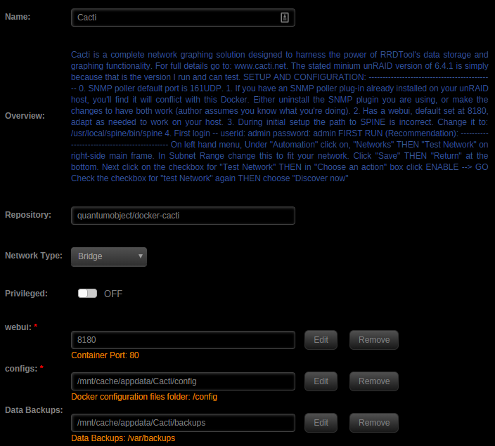

February 18, 20188 yr Application Name: Cacti -- a complete network graphing solution designed to harness the power of RRDTool's data storage and graphing functionality. Application Site: https://www.cacti.net Docker Hub: https://hub.docker.com/r/quantumobject/docker-cacti/ Template-Repository: https://github.com/Jcloud67/Docker-Templates SETUP AND CONFIGURATION: --------------------------------------------- 0. SNMP poller default port is 161UDP. 1. If you have an SNMP poller plug-in already installed on your unRAID host, you'll find it will conflict with this Docker. Either uninstall the SNMP plugin you are using, or make the changes to have both work (author assumes you know what you're doing). 2. Has a webui, default set at 8180, adapt as needed to work on your host. 3. During initial setup the path to SPINE is incorrect. Change it to: /usr/local/spine/bin/spine 4. First login -- userid: admin password: admin FIRST RUN (Recommendation): --------------------------------------------- On left hand menu, Under "Automation" click on, "Networks" THEN "Test Network" on right-side main frame. In Subnet Range change this to fit your network. Click "Save" THEN "Return" at the bottom. Next click on the checkbox for "Test Network" THEN in "Choose an action" box click ENABLE --> GO Check the checkbox for "test Network" again THEN choose "Discover now"

February 23, 20188 yr I don't actually see a save button on 6.4.1 ( https://i.imgur.com/dygrjzB.png ) and it is definitely wiping the entire system every 'apply' of the docker. I think we simply need to figure out where cacti is storing the db/conf shit and make sure that goes in an appdata mount rather than in the normal image. Edited February 23, 20188 yr by anethema
February 24, 20188 yr Author 12 hours ago, anethema said: I don't actually see a save button on 6.4.1 ( https://i.imgur.com/dygrjzB.png ) and it is definitely wiping the entire system every 'apply' of the docker. Sorry about confusion, you definitely don't have one there. Here's mine: https://i.imgur.com/EUpZqzl.jpg And, yeah 'apply' definitely re-builds it each time. I think the save button is activated, by going to ://YourBox/Apps/ca_settings Advanced "Enable Template Developer Mode?" --> Change to Yes and apply.

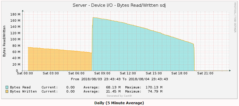

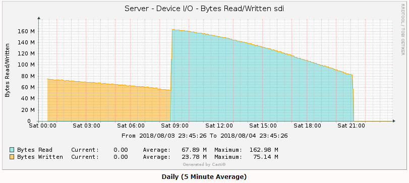

August 5, 20188 yr Last stage of a pre-clear (the Post-Read) on a pair of 6TB WD Reds. The yellow before it was the end of the zeroing pass. I pre-cleared two disks at once, and one of them was noticeably slower overall. That curve show the data transfer speed variance across the disk.
