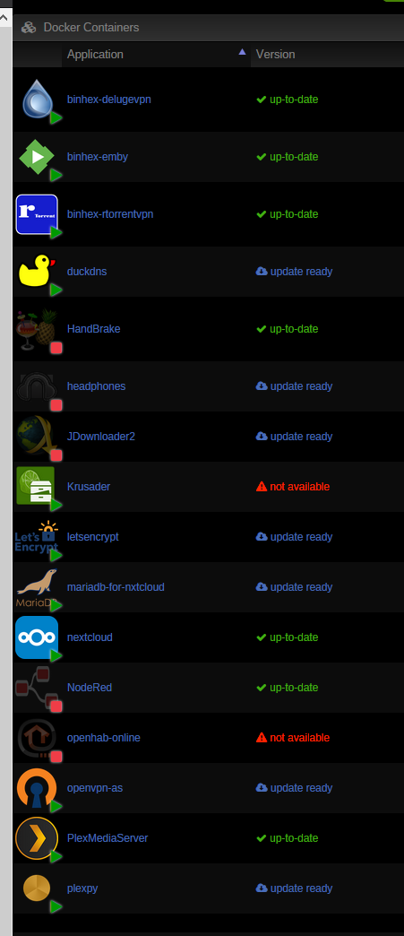

I have a little trouble since I updated to 6.4.0 from 6.3.5 I believe. In the beginning everything was working fine, but after a while my dockers seem to have issues.
First I wss unable to update some of the dockers. I see the update now button but when I do the update it tells me 0B pulled and so on. I will put some examples below.
for some of them it says "not available" instead of "up-to-date" or "update ready".

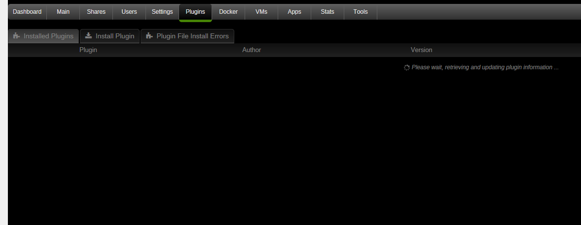

Problem is if I go to the "installed plugins" tab, it keeps loading but never lists the installed plugins. So I am not sure how should check if I have it installed or even uninstall it.
The "install plugin" and the "plugin file install errors" tab work.
There is an error though: /boot/config/plugins-error/dynamix.system.temp.plg
Here are some example of errors when I try to update Dockers:
DuckDNS:
Pulling image: linuxserver/duckdns:latest
TOTAL DATA PULLED: 0 B
Stopping container: duckdns
Successfully stopped container 'duckdns'
Removing container: duckdns
Successfully removed container 'duckdns'
Command:
root@localhost:# /usr/local/emhttp/plugins/dynamix.docker.manager/scripts/docker run -d --name="duckdns" --net="host" -e TZ="Europe/Berlin" -e HOST_OS="unRAID" -e "SUBDOMAINS"="medienkerker" -e "TOKEN"="8afd494c-89e9-4c0e-a1c4-fbe75ad929ab" -e "PUID"="99" -e "PGID"="100" linuxserver/duckdns
0981a3b01684e7214a45c41dc5d51fc57430fac36c0ff9b88737092713504ec0
The command finished successfully!
 mariadb-for-nextcloud:
Pulling image: linuxserver/mariadb:latest
Stopping container: mariadb-for-nxtcloud
Successfully stopped container 'mariadb-for-nxtcloud'
Removing container: mariadb-for-nxtcloud
Successfully removed container 'mariadb-for-nxtcloud'
Command:
root@localhost:# /usr/local/emhttp/plugins/dynamix.docker.manager/scripts/docker run -d --name="mariadb-for-nxtcloud" --net="bridge" -e TZ="Europe/Berlin" -e HOST_OS="unRAID" -e "PUID"="99" -e "PGID"="100" -e "MYSQL_ROOT_PASSWORD"="VKXj4LNUu" -p 3305:3306/tcp -v "/mnt/user/appdata/mariadb-f-nxtcloud":"/config":rw linuxserver/mariadb
d17e47c944f3e2f839822865ea9acb2bad673fdcc79818c173b40f61d748ead9
headphones:
Pulling image: linuxserver/headphones:latest
Removing container: headphones
Successfully removed container 'headphones'
Command:
root@localhost:# /usr/local/emhttp/plugins/dynamix.docker.manager/scripts/docker create --name="headphones" --net="bridge" -e TZ="Europe/Berlin" -e HOST_OS="unRAID" -e "PUID"="99" -e "PGID"="100" -p 8383:8181/tcp -v "/mnt/disks/SAMSUNG_HD103SI_S1VSJD1B502388/DownloadCache/Headphones/Download/":"/downloads":rw -v "/mnt/disks/SAMSUNG_HD103SI_S1VSJD1B502388/DownloadCache/Headphones/Music/":"/music":rw -v "/mnt/user/appdata/headphones":"/config":rw linuxserver/headphones
a58ee41ac3887613dd66593731aa2b9c6f63a4dfa00708cc84c7ad68c21fed4a
What should I do from here?
Thank you.

Plugin page problem.  Best guess is that your server has a bitch of a time communicating with GitHub.com  What happens if you go to settings - Notification settings, and disable the OS Update check and plugin update check, and then go to the plugins page?

The setting was disabled. So I enabled and disabled it. Now the plugins page loads but it takes 4-5 minutes.
