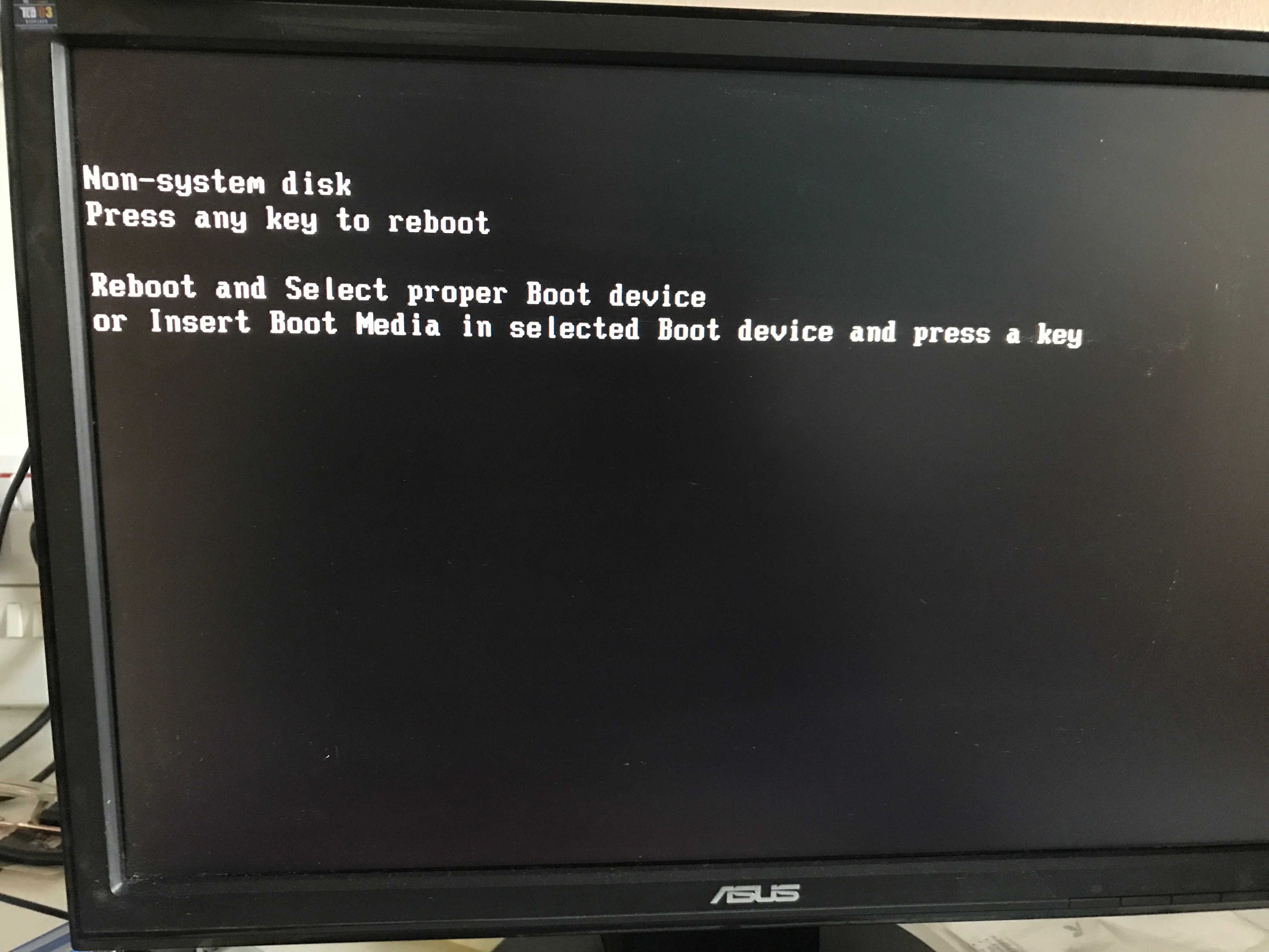

Just a quick update.   Using the same drive as I tried on the Samsung RV511. No changes whatsoever. Just unplugged from the laptop and plugged into another machine. This time with an Asus P5Q mobo. It fails on that too.
I just get the error shown in the photo.
I've just tried to boot unRAID 6.5.0 on the oldest 64-bit motherboard I have (an ECS GS7610 Ultra with Athlon 3000+) and I got the same result. But I know it will boot earlier unRAID versions. I've had 6.0 running on it.
Hmmm interesting.   I'm practically out of ideas now I fail to get it running on one other machine but works fine on another one.    How on earth is this possible?

I'd guess that it's something about old hardware and a new syslinux.
