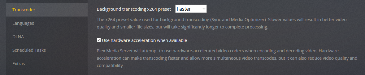

And in your Plex server Transcoder Settings page you need to enable hardware acceleration

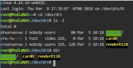

Do you see this on your server?
Do you have a /dev/dri folder with the contents as shown above?
Your E3-1275 V6 CPU definitely has an iGPU and Quick Sync Video support
If you do not have the contents of the /dev/dri folder as shown above, do you have another graphics card in your server, either discrete or onboard (for example, a BMC for IPMI)?  If so, is it set to the primary graphics adapter in the BIOS?  I believe the iGPU needs to be primary in order for the drivers to load for hardware transcoding to work.  If another graphics card is the primary the /dev/dri drivers are not loaded.

Well, you don't have renderD128 and that is the problem.  That is the QSV driver needed for hardware transcoding in Plex.
So, no other graphics card in your server and "onboard (or whatever your BIOS designates for iGPU)" is set to primary adapter in the BIOS?
That was it!  It was set to AUTO!  Changed that and now working!  Thank you so much!

Sorry to bring up this thread ..... I have managed to make all of the changes in the go file and everything is up and running with the docker container however i dont have the checkbox to tick in the transcoder in plex settings yeah i switched to advanced XD how can i get this ???
I'm not sure if this is still the case, but at one point you had to be a Plex Pass subscriber for that feature
