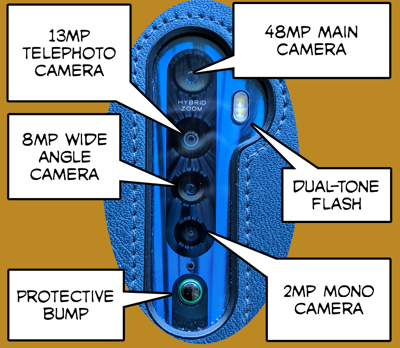

@bidmead Awesome looking annotations 🤩 What program are you using to do this?
It's for creating comics. An Android app called PicSay. Very easy and useful. I use it quite a bit.
Chris
