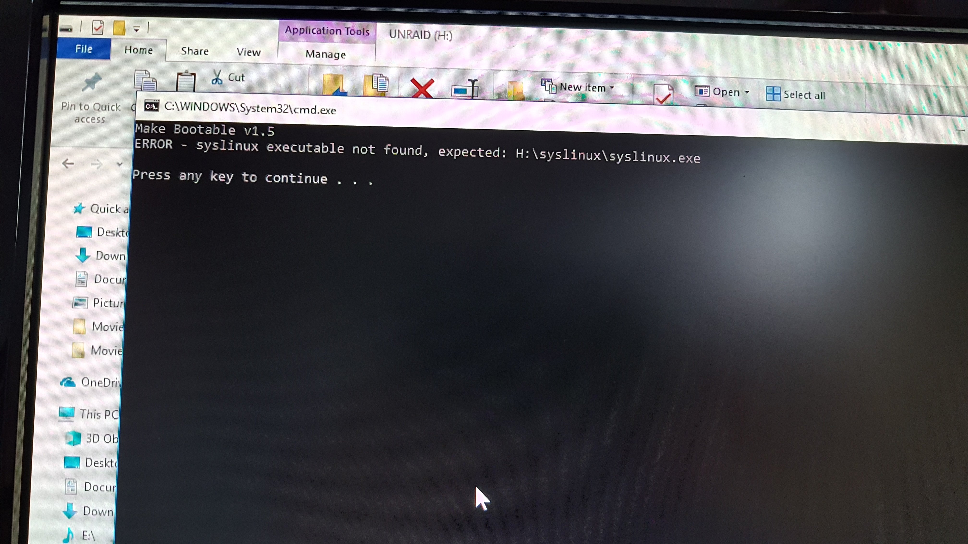

Well my new usb arrived and did a backup through unraid OS, shut down server, reformatted USB with title UNRAID and fat32 copied files over from backup download , plugged in unraid server and it wont boot, went into bios new USB detected as 1st and only boot option restarted but still wont boot. What did i miss ?? Any help
Did you run the proper make-bootable script for the OS on your PC? See  here:
Run the make bootable script.
From Windows XP, just double-click the make_bootable file.
From Windows 7 or later, right-click the file and select ‘Run as Administrator’.
From Mac devices, double-click the file ‘make_bootable_mac’ and enter your admin password when prompted.
NOTE:  during the process of running this script, the flash device may seem to disappear and reappear on your workstation a few times – this is expected behavior.
Thanks very much for your reply message when try to make bootable 20180530_153401.thumb.jpg.ad974288107472b619b625eb427575ec.jpgy getting error
Fixed it many thanks for help new much much smaller usb fitted and working thanks again
