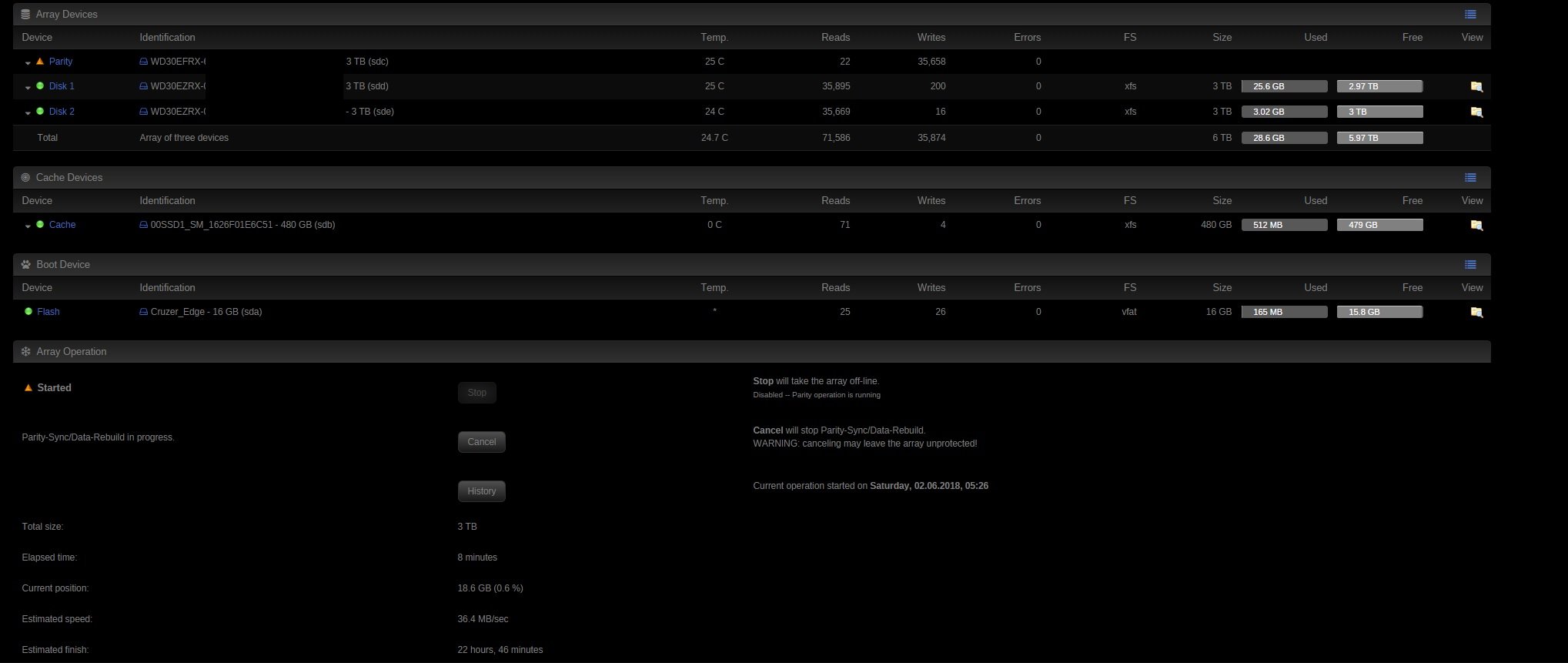

I only have 36MB/s at the sync with four HDDs.
If i put one out, the speed goes up to 140MB/s and thats ok i think.
But why the speed drop down, if i use more HDDs?

Please post your diagnostics: Tools -> Diagnostics
Problem is very likely the controller you're using, try using the onboard SATA ports and it should perform much better, if you need an HBA get an LSI instead.
