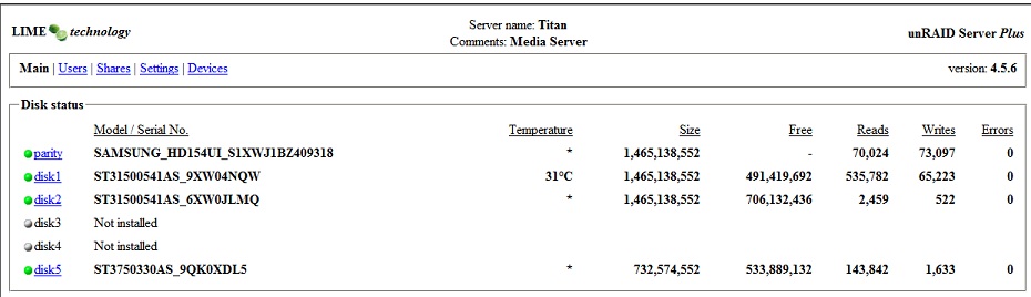

This is a good question that I have wondered about myself.  When I built my unRAID server I feared that mixing same sized drives from different manufacturers would have slight size variations between brands.  In my case I mixed Seagate with Samsung (all 1.5TB drives) and unRAID reports them as exactly the same sizes.
I don't know if this will be the same with all manufacturers but so far it has worked for me.
